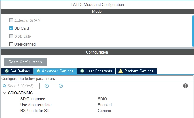

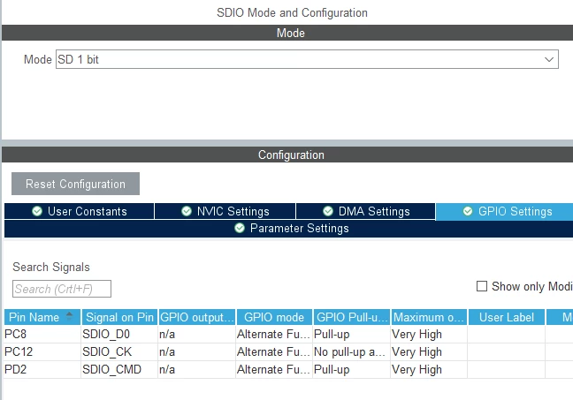

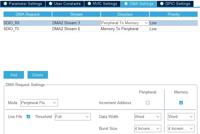

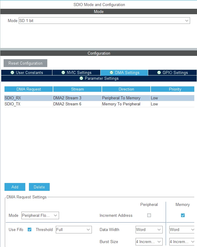

Now, 1 bit + DMA mode, that's not working well. It reads fine, creates files, but ALWAYS double writes things to files!
  • Pull ups enabled or disabled, it doesn't make any diffrence
  • DMA template - enabled

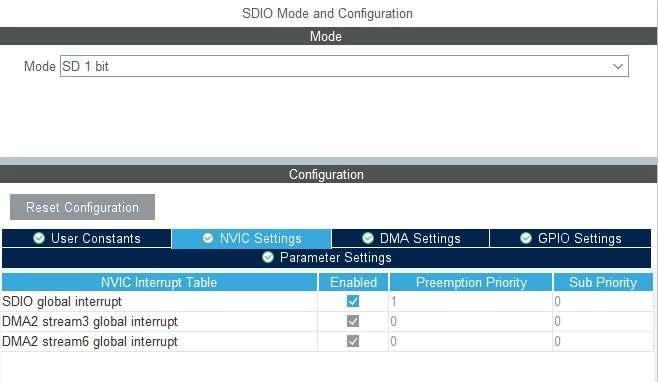

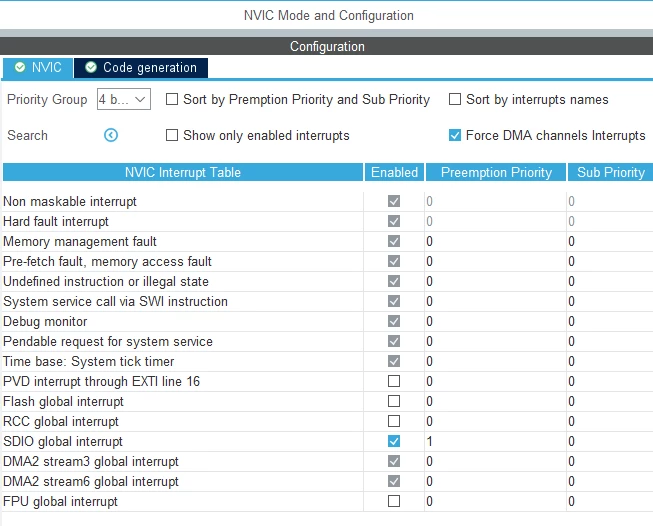

0693W00000D1bYdQAJ.pngNow a little comment on the priority: I tried setting SDIO global interrupt preemption priority to 1 so it would be lower than dma's interrupt, but it didn't work.

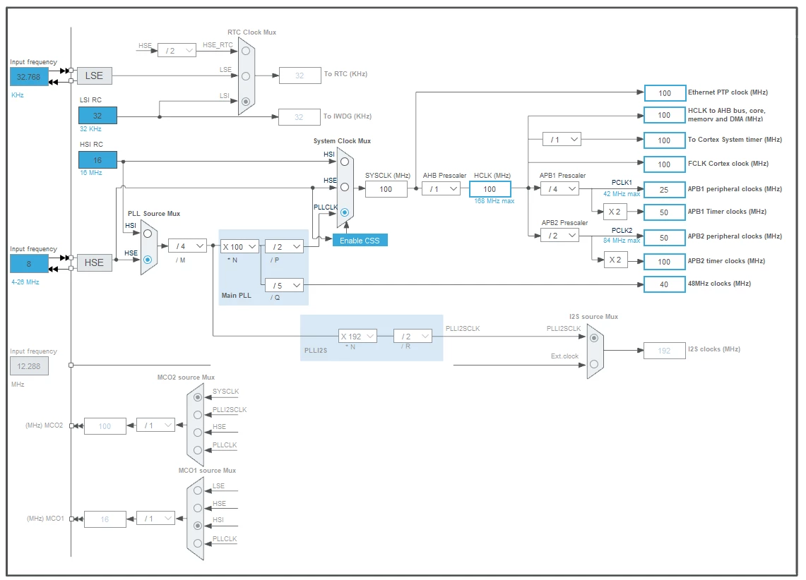

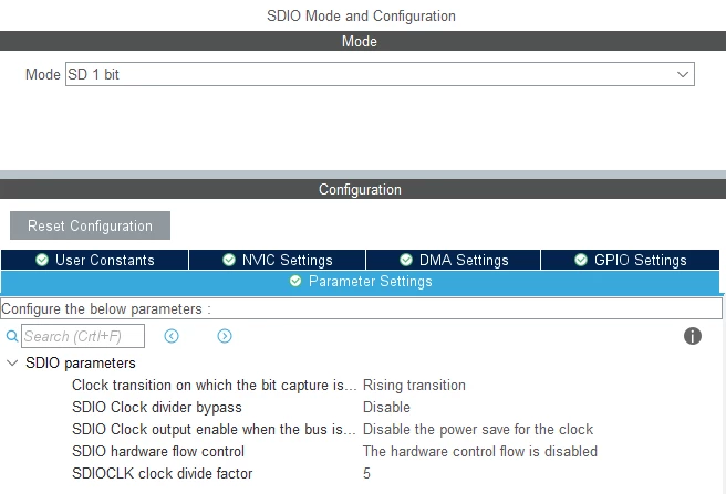

Clock configuration the same as in the previous example.
Also, I tried decreasing clock speed on SDIO, by setting APB2 to 24MHz, or by increasing the CLK divide factor - it didn't help.

 hdma_sdio_rx.Instance = DMA2_Stream3;
 hdma_sdio_rx.Init.Channel = DMA_CHANNEL_4;
 hdma_sdio_rx.Init.Direction = DMA_PERIPH_TO_MEMORY;
 hdma_sdio_rx.Init.PeriphInc = DMA_PINC_DISABLE;
 hdma_sdio_rx.Init.MemInc = DMA_MINC_ENABLE;
 hdma_sdio_rx.Init.PeriphDataAlignment = DMA_PDATAALIGN_WORD;
 hdma_sdio_rx.Init.MemDataAlignment = DMA_MDATAALIGN_WORD;
 hdma_sdio_rx.Init.Mode = DMA_PFCTRL;
 hdma_sdio_rx.Init.Priority = DMA_PRIORITY_LOW;
 hdma_sdio_rx.Init.FIFOMode = DMA_FIFOMODE_ENABLE;
 hdma_sdio_rx.Init.FIFOThreshold = DMA_FIFO_THRESHOLD_FULL;
 hdma_sdio_rx.Init.MemBurst = DMA_MBURST_INC4;
 hdma_sdio_rx.Init.PeriphBurst = DMA_PBURST_INC4;
 if (HAL_DMA_Init(&hdma_sdio_rx) != HAL_OK)
 Error_Handler();
 __HAL_LINKDMA(hsd,hdmarx,hdma_sdio_rx);
 /* SDIO_TX Init */
 hdma_sdio_tx.Instance = DMA2_Stream6;
 hdma_sdio_tx.Init.Channel = DMA_CHANNEL_4;
 hdma_sdio_tx.Init.Direction = DMA_MEMORY_TO_PERIPH;
 hdma_sdio_tx.Init.PeriphInc = DMA_PINC_DISABLE;
 hdma_sdio_tx.Init.MemInc = DMA_MINC_ENABLE;
 hdma_sdio_tx.Init.PeriphDataAlignment = DMA_PDATAALIGN_WORD;
 hdma_sdio_tx.Init.MemDataAlignment = DMA_MDATAALIGN_WORD;
 hdma_sdio_tx.Init.Mode = DMA_PFCTRL;
 hdma_sdio_tx.Init.Priority = DMA_PRIORITY_LOW;
 hdma_sdio_tx.Init.FIFOMode = DMA_FIFOMODE_ENABLE;
 hdma_sdio_tx.Init.FIFOThreshold = DMA_FIFO_THRESHOLD_FULL;
 hdma_sdio_tx.Init.MemBurst = DMA_MBURST_INC4;
 hdma_sdio_tx.Init.PeriphBurst = DMA_PBURST_INC4;
 if (HAL_DMA_Init(&hdma_sdio_tx) != HAL_OK)
 Error_Handler();
 __HAL_LINKDMA(hsd,hdmatx,hdma_sdio_tx);

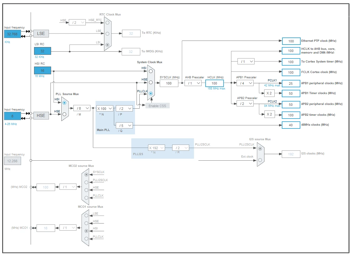

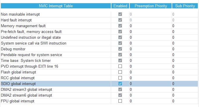

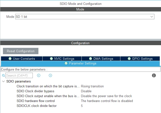

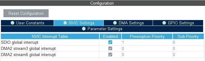

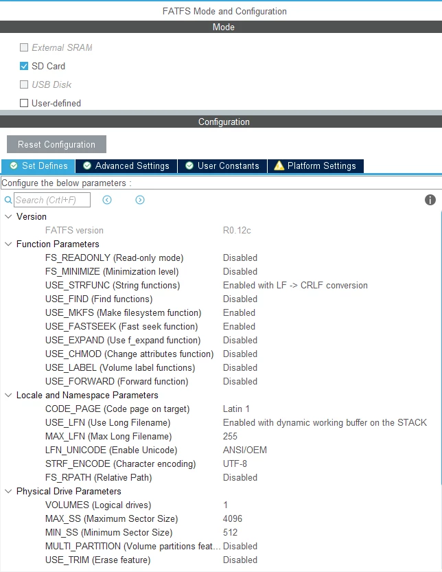

UPDATE:
I got 1bit+dma to work. Here is my config in CubeMX for anyone struggling too:
0693W00000D1htrQAB.png0693W00000D1htmQAB.png0693W00000D1hthQAB.png0693W00000D1htcQAB.png0693W00000D1htSQAR.png0693W00000D1htNQAR.png0693W00000D1htIQAR.png0693W00000D1ht8QAB.png
