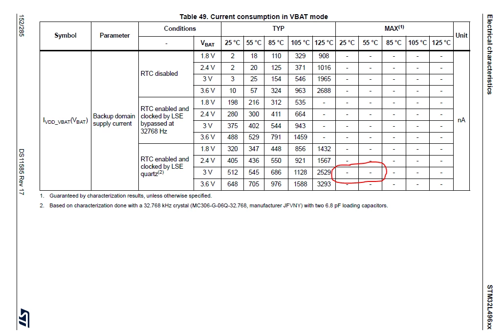

STM32 RTC maximum current consumption in VBAT mode
With reference to STM32L496xx datasheet (DS11585 rev 17) page 152 table 49, can maximum values be provided for IVDD_VBAT with RTC enabled and clocked by LSE quartz, for VBAT=3.0V and at 25°C and 55°C? (The red marked cells)

I asked the question to online support
2 replies
September 1, 2023
Hello @S.Nygaard
Theses values are not available. And for Max counsumption value of STM32L496, we will also not be able to restart a data collection process in future .
Regards
Diane
