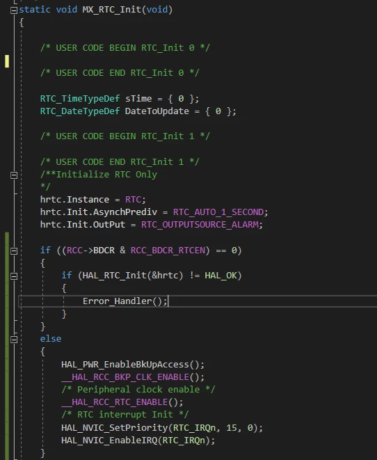

MSine
MSineBest answer
Visitor II
February 21, 2019
I solved this problem in the following way:

Siddharth Singh
Visitor II
May 27, 2017
Posted on May 27, 2017 at 15:07
I have the exact same problem. I am using STM32F103, CubeMX and an external LSE 32.768 KHz crystal with VBat source as a CR2032 Lithium cell. The clock is keeping accurate time while either on power or on backup coin cell. However, I lose around 500 - 600 ms every time the micro is powered up or if I reset the micro using the reset button.
If I hit reset button 100 times, I lose close to a minute.
I do not suspect the crystal as I have taken measurements using an oscilloscope and also I have enabled output on RTC pin and the timing measures perfectly.
It has something to do with the initialization and I have not been able to figure that out so far!
waclawek.jan
May 28, 2017
Posted on May 28, 2017 at 16:26
If the RTC is already running, you need no initialization at all.
AVI-crak
Senior
December 6, 2017
Posted on December 06, 2017 at 15:08
Checking, performing a new initialization of the clock in case of an error:
if (! ((RCC->BDCR & RCC_BDCR_LSERDY) /// hour quartz worked before
&&(((RCC->BDCR) & RCC_BDCR_RTCSEL ) == RCC_BDCR_RTCSEL_0) /// switch on external clock quartz
&&((RCC->BDCR) & RCC_BDCR_RTCEN)) )/// the clock is already working
//Your code for starting the clock and calendar

coppercrimp
May 30, 2017
Posted on May 31, 2017 at 01:45
After some trial and error I came up with a solution that seems to work. The key piece Iseemed to be missing was this:
You SHOULD configure the peripheral clock for the RTC every time the themicrocontroller resets. I.e. the following code:
RCC_PeriphCLKInitTypeDef PeriphClkInitStruct;

MSineBest answer
Visitor II
February 21, 2019
