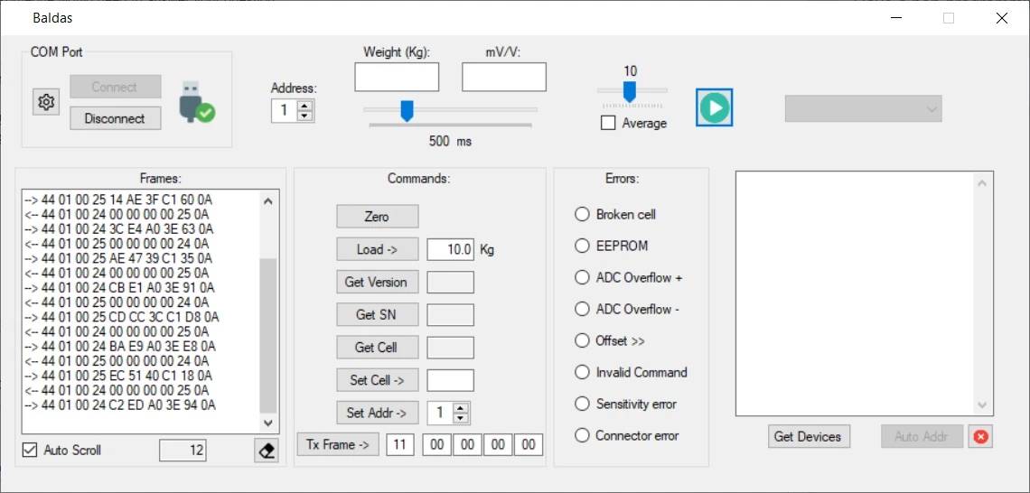

I have a weight cell which replies to specific frames over RS485 (cell contains its own communication protocol). Manufacturer has a software to test the cell so I connect it to my pc using a RS485 to USB converter and I am able to connect to the cell and send/receive frames. Here are the parameters I use and you can see TX-RX frames below:

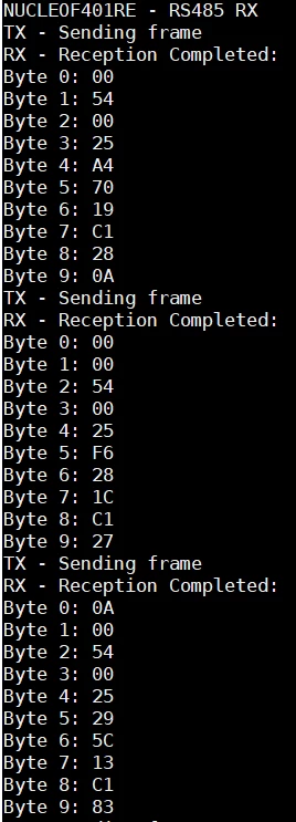

I should be receiving a frame starting with 0x44 and ending with 0x0A based on the cell protocol. However, this is what I receive:
I have tried many different UART parameters, many different pin configurations and tried using a 120 ohm and 220 ohm resistors between A and B lines but nothing works. What am I missing?

I noticed your code doesn't match your output. There is no output for the "printf("RX - Reception Completed:\r\n");" line, but the other printf lines have output.
Edit: actually, "printf("TX - Sending frame\r\n");" doesn't match your output either.

My bad, I uploaded the wrong image. I have edited the post and now you can see the output of the current program.
