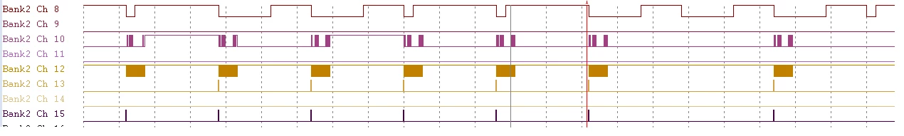

Hi, I need to modify a PWM inside an interrupt, I though that It would be easy, just changing CCR2 to the new desired value but it is not working properly.
The change is not happening each pulse, it is a bit random.. not sure why. If i set 3000, it works right, if I set 17500 it works right, but if i set a condition to change from one to the other value then it doesnt work because it doesnt change in each interrupt, at it is even a bit random  (image below)...
My code is simple..., after each TIM5 interrupt I want a new PWM (in this example 2 values, in my real code more values, but I wanted something easy to show here)

Bank2 CH 8 is the PWM TIM 9 CH2 while Bank2 ch 15 is the IRQ (TIM 5)

You need two timers why? Why the different periodicity? Why not just set the pulse width in the TIM's own interrupt?
You'd probably want to set the CNT to zero first, and consider if you can get the master/slave relationship set up so one timer resets the other.
