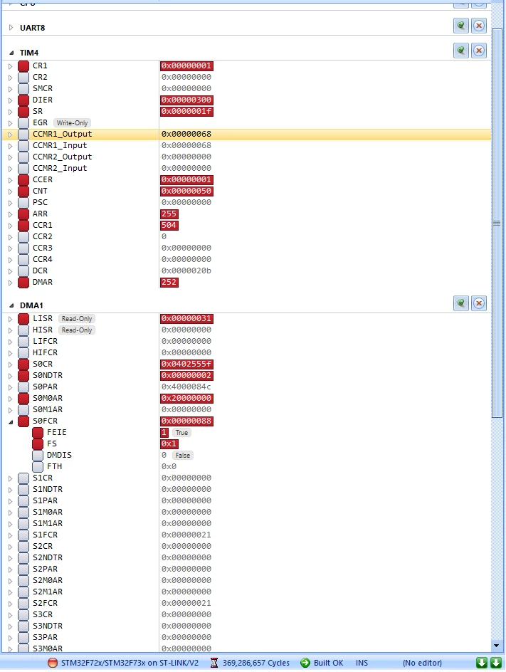

Thanks for the reply, I tried the TIM DMA, and got the DMA and TIM register to the following settings, however it seems that no interrupt is happening, I don't see the ARR change. Can you help me check if my settings are correct ?0693W000001rMPsQAM.png

Okay, from the screenshots we can guess it's 'F723. You should've told us.
DMA1 Stream 0 (set to Channel 2) is triggered by TIM4_CH1, you should've set TIM4_DIER.CC1DE for that.
Then that should work, but IMO it's better to leave the trigger from update (DIER.UDE=1 as it is now), and use the respective DMA1 Stream 6 (at channel 2).

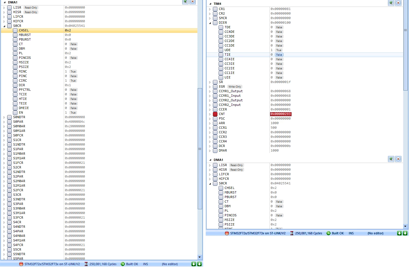

Hi thanks for the reply ! I have got the interrupt now and the DMA is running, however I encounter something very strange.
so I have set an data array
#define n 9
#define transfer 6
uint32_t buffer[n] = {500, 251, 252, 253, 504, 255, 506, 257, 258};
uint32_t DCR = 0x20B;
and I call the following function to kick start:

int main(void)
 htim4.Instance->ARR = 1000;
 htim4.Instance->CCR1 = 100;
 HAL_TIM_PWM_Start_DMA_MODIFIED(&htim4, TIM_CHANNEL_1, buffer, transfer);

I was expecting:
arr[] = 1000, 500, 253 ...
ccr1[]=100, 251, 253 ...
what I actually got is:
arr[] = 1000, 1000, 252 ...
ccr1[]=100, 251, 504 ...
why is this so strange ? It says in the document if I set DCR to 0x20B, it should DMA 3 element in the array each time the DMA is triggered, why the pattern seems so "random".
here is my register set:0693W000001rRn0QAE.png

I don't understand what are you trying to do, but don't use both the CC1DE and UDE - use only UDE and change the DMA stream as I wrote above.

It depends on the very details of how your program is written, but if you still use Cube, maybe you are confused by the extra Update generated by the Cube init code setting TIM_EGR.UG.

Is there a way to check the current DMA count and address ?
waclawek.jan
June 26, 2020
Observe the DMA NDTR register.

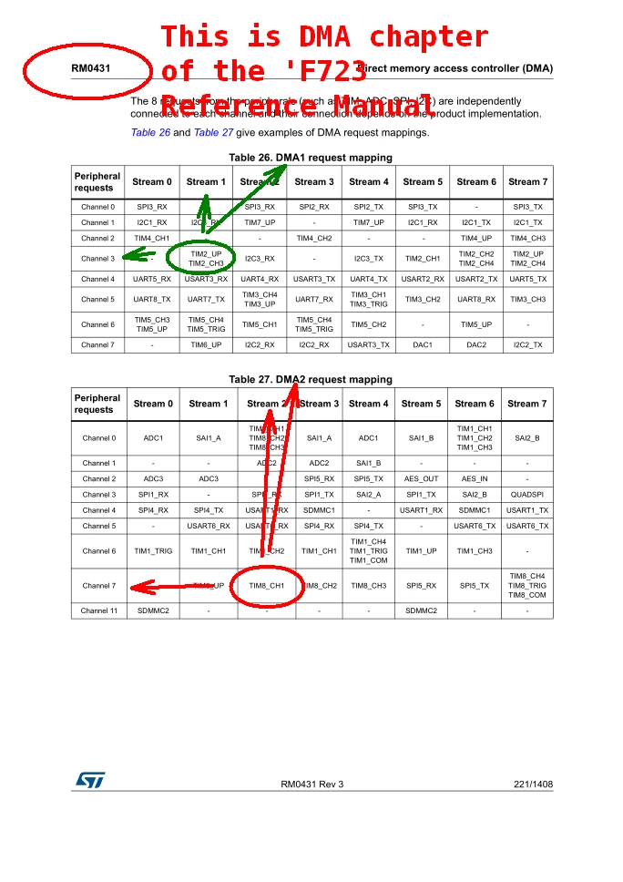

Hi thanks for the reply, another question, in which document is it written TIM4 UDE is bound to DMA1 stream 6 ?, If I were to change to TIM2_CH3 and TIM8_CH1, what are the respective DMA stream ?
waclawek.jan
June 30, 2020
