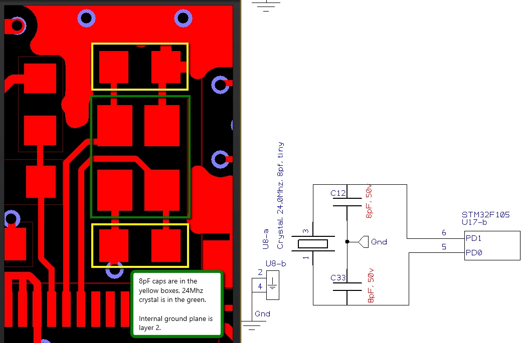

I'm using the STM32F105R8 on a custom 4 layer board.  Boot0 is pulled to ground via a 10k resistor.  Boot1 is floating.
The board is based on some open hardware with associated open source software.  I'm using the same crystal and caps as the reference hardware does.

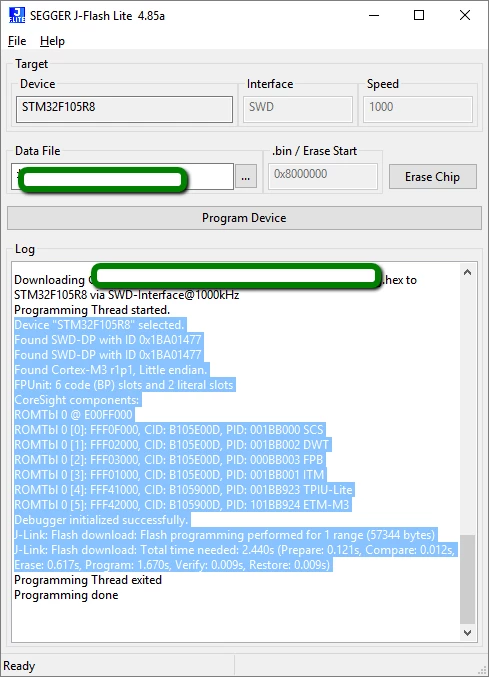

I'm able to program it using segger J-Flash lite (see image attached below).
But, it doesn't appear that the code is actually running.  When I probe the oscillator pins, I see something, but it's basically noise.  Not a nice wave like I was expecting.  So I'm thinking this is why the code isn't running.
This is the crystal I'm using:
https://www.digikey.com/product-search/en?keywords=644-1052-1-ND
And this is the 8pf capacitor I'm using:
https://www.digikey.com/product-search/en?keywords=445-5042-1-ND
The schematic and layout are attached below.
Does anybody know why it's not starting?

    And have you stepped though, or done any debugging, on your code?
    Does it start the oscillator? The part runs initially off it's internal 8 MHz HSI, so should be quite capable of outputting to LEDs or USARTs without the external clock starting.
    What's NRESET doing? Can you do basic signs-of-life tests via USART1 and the System Loader?

    Well huh. I got these tools installed in Windows, and I can step through and blink my leds.
    http://gnuarmeclipse.github.io/ It sure looks like it's initializing and using the external oscillator.
    HSEStatus
    = 1 so drops out of this loop before hitting the timeout.
