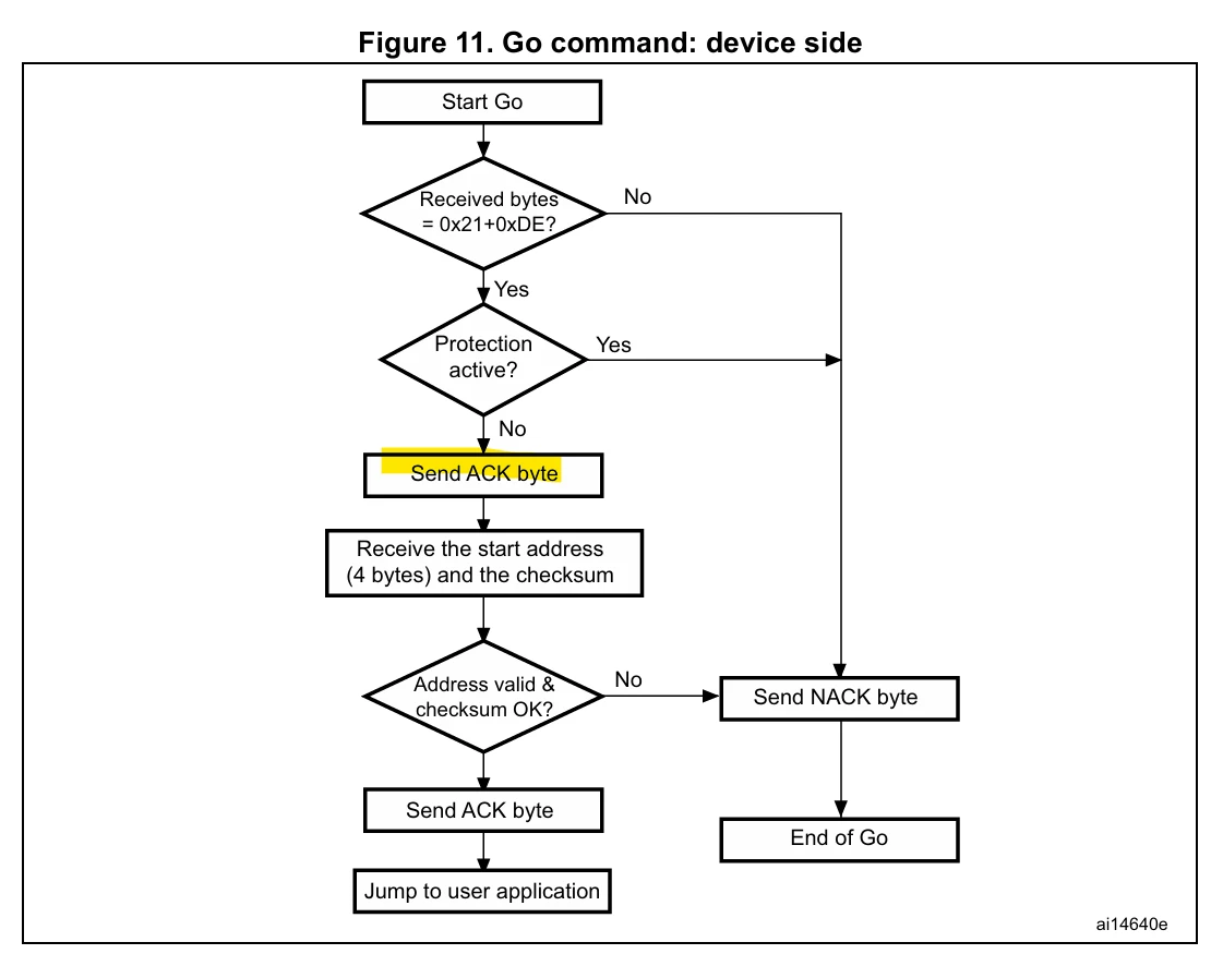

In attempting to figure out how to stay in the bootloader loop while exchanging packets with the USB DFU tool I came across as what looks like an unintentionally undeleted line of code.
Here is the code:
static void OPENBL_USART_Go(void)
 uint32_t address;
 uint32_t mem_area;
 /* Check memory protection then send adequate response */
 if (OPENBL_MEM_GetReadOutProtectionStatus() != RESET)
 OPENBL_USART_SendByte(NACK_BYTE);
 else
 OPENBL_USART_SendByte(ACK_BYTE);
 /* Get memory address */
 if (OPENBL_USART_GetAddress(&address) == NACK_BYTE)
 else
 /* Check if received address is valid or not */
 mem_area = OPENBL_MEM_GetAddressArea(address);
 if ((mem_area != FLASH_AREA) && (mem_area != RAM_AREA))
 else
 /* If the jump address is valid then send ACK */
 OPENBL_MEM_JumpToAddress(address);
It looks like the statement on line 13 should be deleted.  If we don't it's going to send both an ack and either an ack or a nak, for one received message.  This is in the OpenBootloader repo, in the ST-Micro supplied file Source/OpenBootloader/Middlewares/ST/OpenBootloader/Modules/USART/openbl_usart_cmd.c

That particular ACK acknowledges protection is not active and the host can send the address. It's not a bug. It's in the UART protocol document here:
Multiple ACKs can be and often are within the same command.
cd00264342-usart-protocol-used-in-the-stm32-bootloader-stmicroelectronics.pdf
