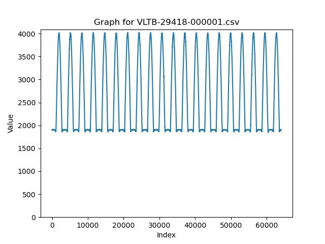

I am testing my circuit with a 3.3V sine wave that has a 1.65V DC offset.
PC01 has the Signal Input
PC02 has the 1.65V.
Looking at the output file from the ADC, I am not getting the total signal. 0-4096. My wave is between 1000 and 3000 approx.
Is there a reason why the signal is attenuated 50%?
I signal on the input has a 3.3V amplitude on a scope at the PIN.
Any help would be appreciated!
Thank you

Jan 2, 2025 8:50 PM UTC
The total range of a differential input is [-3.3, +3.3]. Your signal is only half of that, hence the half-range output.
The range of a single ended signal is [0, +3.3], so half the range and twice as sensitive compared to a differential signal. Sensitivity is halved when you switch to differential mode.

OK... I just re did the test. That was my thought as well, but it seems to be missing half the signal.
[-3.3, +3.3] signal.
I have rewired the -ve Diff input to ground PC2
But I am not getting the whole signal. (Attached the output)
Thanks for the quick reply.
TDKBest answer
Jan 3, 2025 12:04 AM UTC
Both the positive and negative must be in the range [0, 3.3]. You are seeing clipping due to the protection diodes when the signal below ground.
The only way to get 0 counts out of the differential ADC channel is to have the positive input at 0 and the negative input at 3.3.
Similarly, the only way to get max counts is to have the positive input at 3.3 and the negative input at 0.

I rewired the +Vref to get a full signal swing for my needs.
