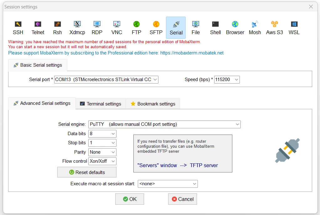

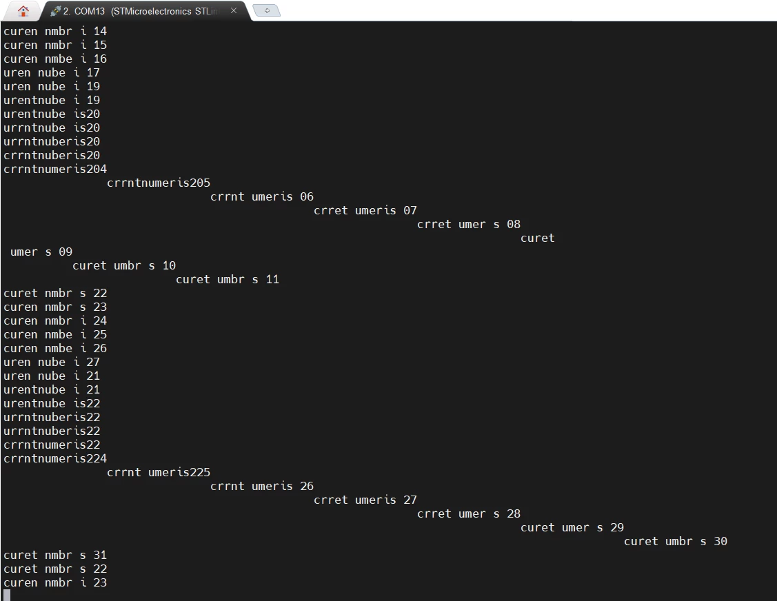

I am facing very basic issue. My UART in H7A3ZI Nucleo 144 board is not displaying correctly on terminal.

My Buad rate is 115200
This is basic code to get UART output data on ST link virtual serial port that is connected to Laptop.

A fundamental requirement of asynchronous serial comms - ie, UART comms, as here - is that the sender and receiver must be working at the same baud rate.
If the baud rates differ, the receiver will not be able to correctly recognise what was sent.
For reliable comms, the baud rate error should not exceed about 2%.
The above is all entirely general - not specific to ST or STM32.
The sending baud rate on your STM32 is derived from the clock; so, if your clock is not what you think, then the baud rate will be wrong - and you will get corrupted comms:

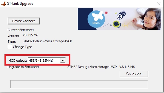

Watch what value HSE_VALUE is using, against the MCO frequency the ST-LINK/V3 is actually generating.
25 MHz / 3 = 8.333333 MHz, not 8.000 MHz
The firmware update tool should provide some clocking options.

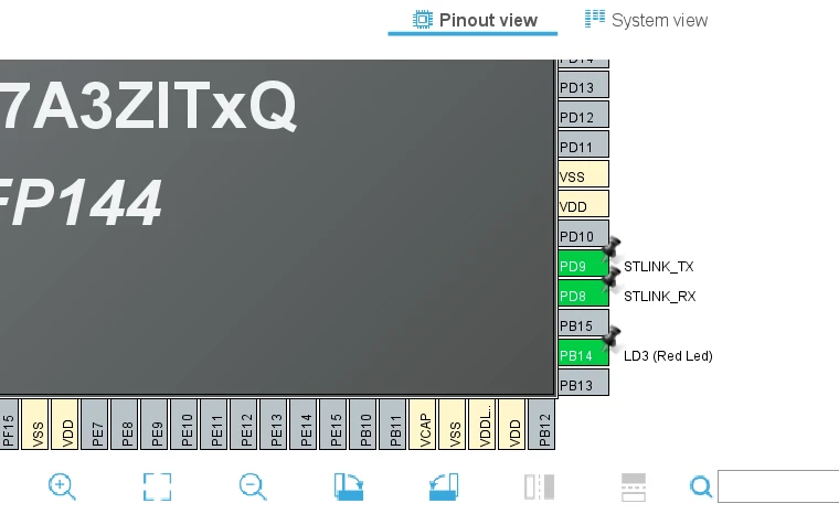

mƎALLEm
Could you please share your ioc file? What clock source you set? HSE or HSI?
If you are using HSE in Bypass mode you need to check the Clock source frequency generated by the ST-LINK over MCO.
Could you please check this information using ST-Link Upgrade tool and see what MCO output is set?
By default it's set to HSE/3 = 8.33MHz.
