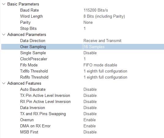

Currently i am working with nucleo-h743zi2 board. I set the Baud rate in CubeMx to 115200. In the Hercules program, when I set the baud rate to 115200, the data does not flow correctly, but when I set the baud rate to 38400, it flows correctly. Why might this problem occur? My CubeMx settings can also be seen in the photo.

Could you please share a minimal project that reproducers the issue?
Are you using USART3 and STLINK Virtual comport?

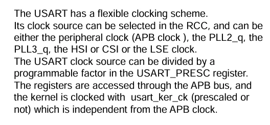

When I looked at the UART documentation for this card, I saw that clocks such as HSI, LSE should be used instead of HSE.
Where did you find this information? could you please share screenshot of that? because this doesn't make sense!

You can find it in the document in ST website which name is "STM32H7-Peripheral-USART interface (USART)". Write it google you will find this document. I attached the photo of the part where I solved my own problem.

Before the problem is solved, i chose the HSE from the clock configuration in CubeMX. After i read the documentation, i chose the HSI clock and my problem is solved. Uart receiver and transmitter is working fine now. I dont change anything except this.
