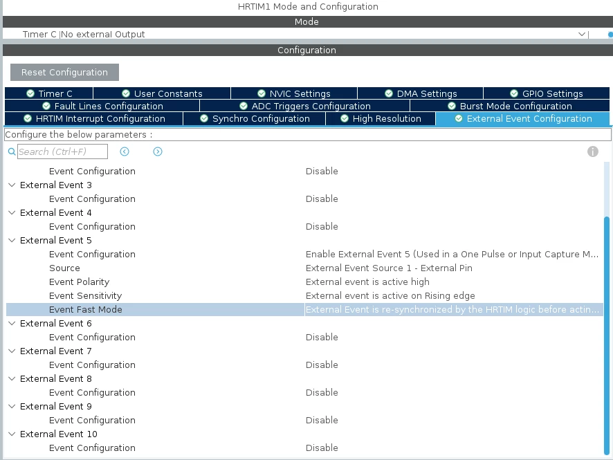

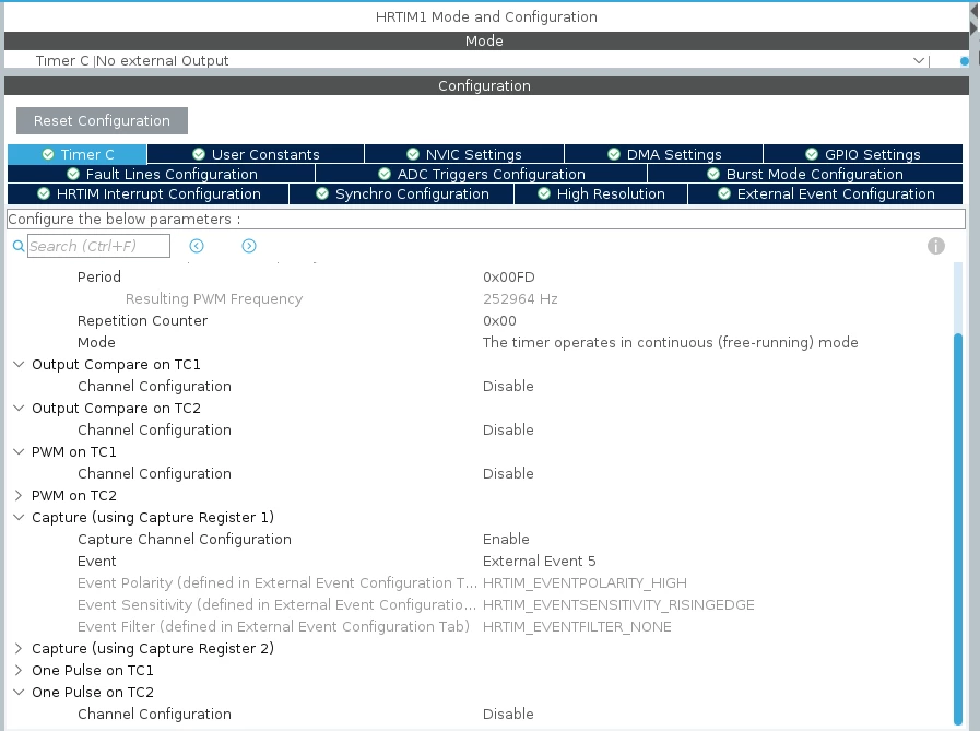

I want to use input capture mode with high resolution timer(HRTIM) on stm32f334r8 microprocessor. I am sending a pulse signal over the oscilloscope. I use one of the External Event Input pins for this. I want to capture the rising edges of the pulses I send using the HRTIM_Simple_Base_Start function. However, I couldn't do that. The settings I made regarding the configuration are as attached. How can I use input capture mode with HRTIM?

capture should work - but what you wanna capture ??
you set counter free running + capture (event 5) -> seems no sense to me, you will get just random values this way.

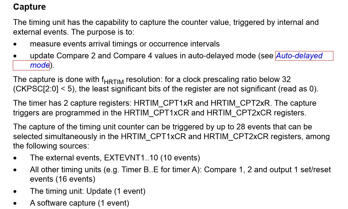

September 6, 2023
Referring to the RM0364. p.643 read:
