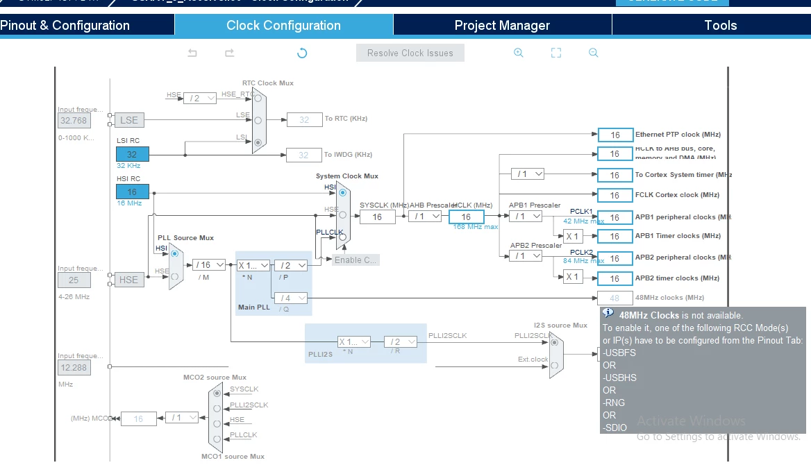

Async serial on USART1 would just need the PA9(TX) and PA10(RX)
If the hardware hasn't otherwise been validated, you might want to sit in a loop transmitting 'U' characters, and scope the signals. PA9 would have the signal, it will be at CMOS levels, and not directly compatible with RS232 levels.

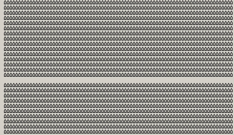

Oct 20, 2019 9:09 AM UTC
I have connected PA9(TX) STM32 to FT232 (RX) and PA10(RX) STM32 to FT232 (TX) (No level shifting is done) (Baud-rate 115200)
This setup worked with some programs compiled with mikroC..
I have attached my terminal output..
I will check with the 'U' loop as you advised..

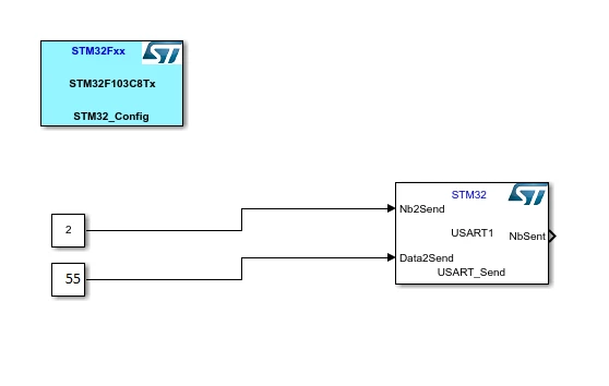

I have tried another character loop in UART
Model that I used to send the character is attached, is it correct?
I intended to send 'U"

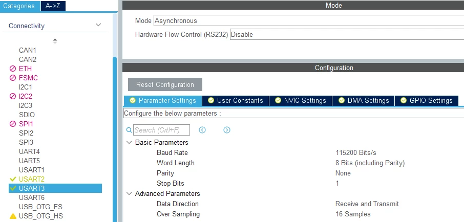

Sure seems like a protocol issue. Same baud rate, parity, and stop but settings in your code and in the terminal? If you have a parity bit, you need to set 9 data bits in the code instead of 8.
vlal
vlalAuthor
Oct 21, 2019 2:23 PM UTC
Yes, it same baud rate 115200, no parity, 1 stop bit
I have changed the data bit 8 and 9 checked, no improvement

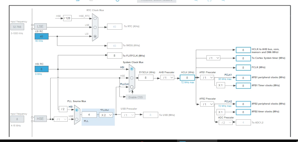

By the way, this is my clock configuration

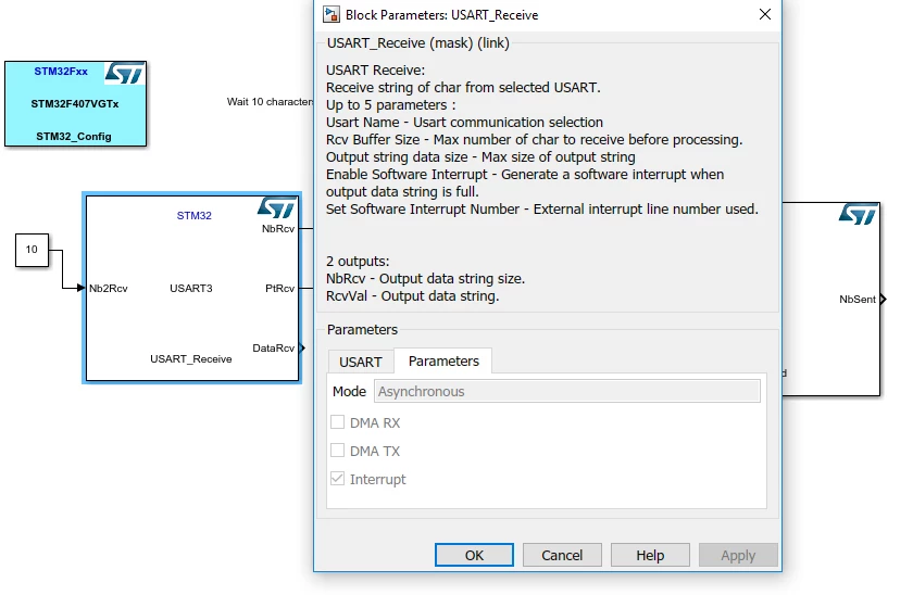

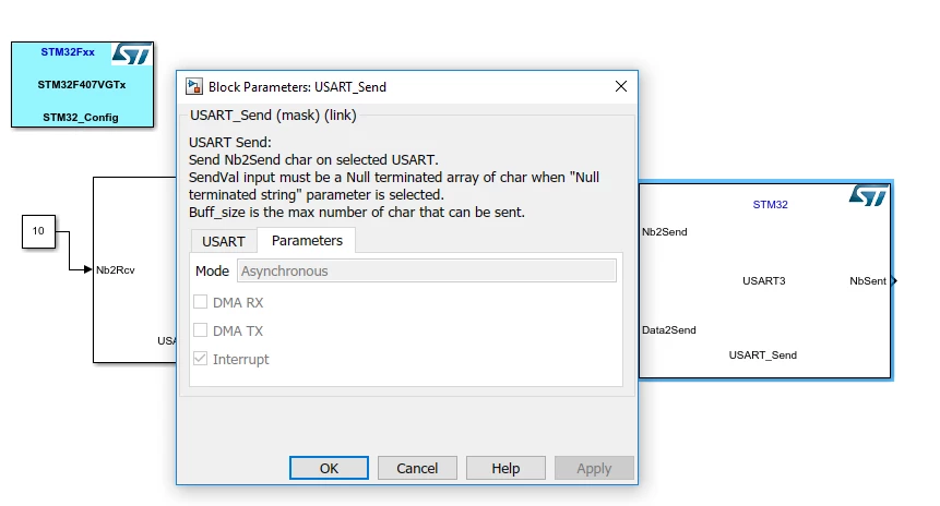

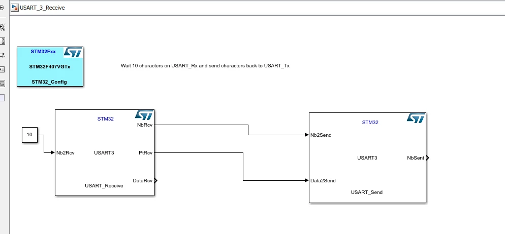

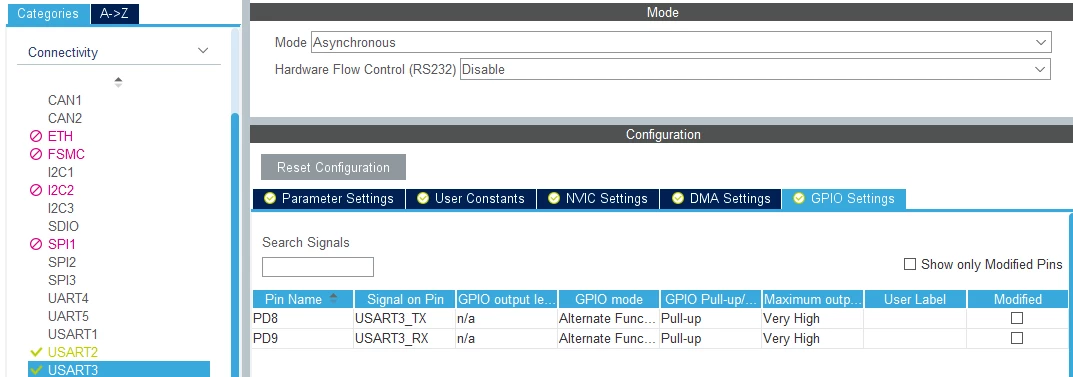

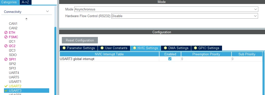

I have been behind this to get working for last 5 months or more but didn't able to get it working
I am attaching pictures of the screenshot, kindly some one help me

Apr 4, 2020 6:39 PM UTC
I made the UART working by making some modifications, that i have mentioned in that post in this thread
but the loopback example, I didnt able to make it working
