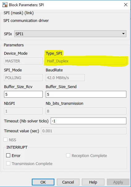

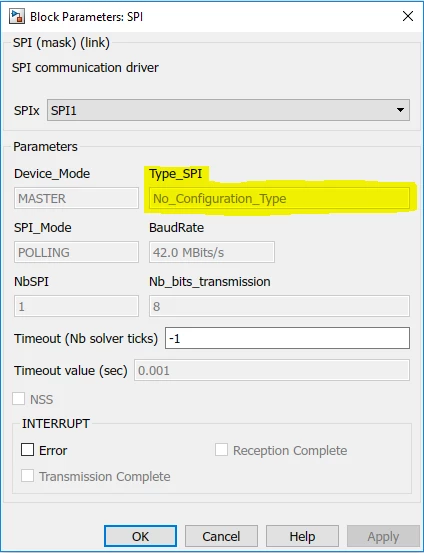

I was trying to get Simulink to communicate to a sensor using SPI, but I encountered the following issue:
When opening the parameter screen of the SPI block by double clicking on it, the ''Type_SPI'' field contains ''No_Configuration_Type'' instead of ''Full_duplex''. This does not happen with any of the three other modes for this field (Half_Duplex, Receive_Only and Transmit_Only).
Due to this bug it is not possible to configure the SPI peripheral as full duplex.
This happens in all SPI ports.
This specifically has to do with the ''SPI1.Direction=SPI_DIRECTION_1LINE'' rule of the .ioc file.
If this value is set to SPI_DIRECTION_2LINES (as required for full duplex config), simulink will parse it as any other invalid value. The SPI_DIRECTION_1LINE value will be parsed correctly as half duplex.
This seems like a bug in the processing of the .ioc file, any ideas?

    Imen.DBest answer
    Apr 27, 2017 8:44 AM UTC
    Posted on April 27, 2017 at 10:44
    Thank you
    Goossens.Sebastiaan
    for sharing your ioc file.
    I confirm this bug and it will be fixed for the next release.
    Thanks
    Imen

    sebastiaan goossens
    Apr 25, 2017 11:14 AM UTC
    Posted on April 25, 2017 at 13:14
    I compared my .ioc file to the one in the 'STM32-MAT\STM32\STM32demos\Test\SPI' example and it seems that deleting the line 'SPI1.Direction=SPI_DIRECTION_2LINES' from the .ioc file fixes the problem en lets matlab recognize the SPI device as full duplex master.
    Can this be fixed in a new STM32-MAT version? Doing this manually with each configuration change is not really ideal.

    Imen.DBest answer
    Thank you
    Goossens.Sebastiaan
    Thanks
    Imen
