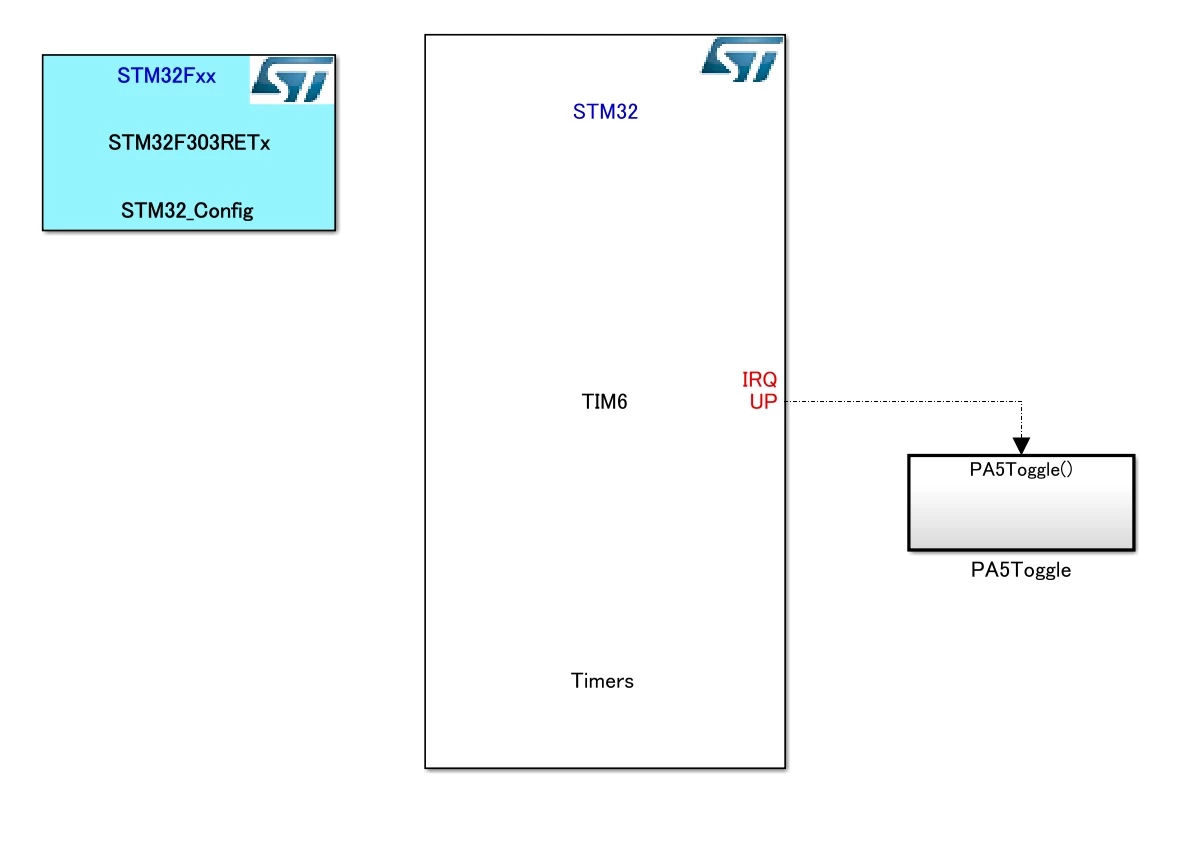

I'm trying to compile a simple Simulink model (TIM6 timer that toggles the PA5 pin, configured as GPIO_Output).
I get this error while compiling in IAR :
"Warning[Pe223]: function "__HAL_TIM_SetAutoreload" declared implicitly
However, if I use an another MCU (like the STM32F407VGTx) configured in the same way, I don't get that error!

*/Line 87 is posing a problem.
Can anybody help?
