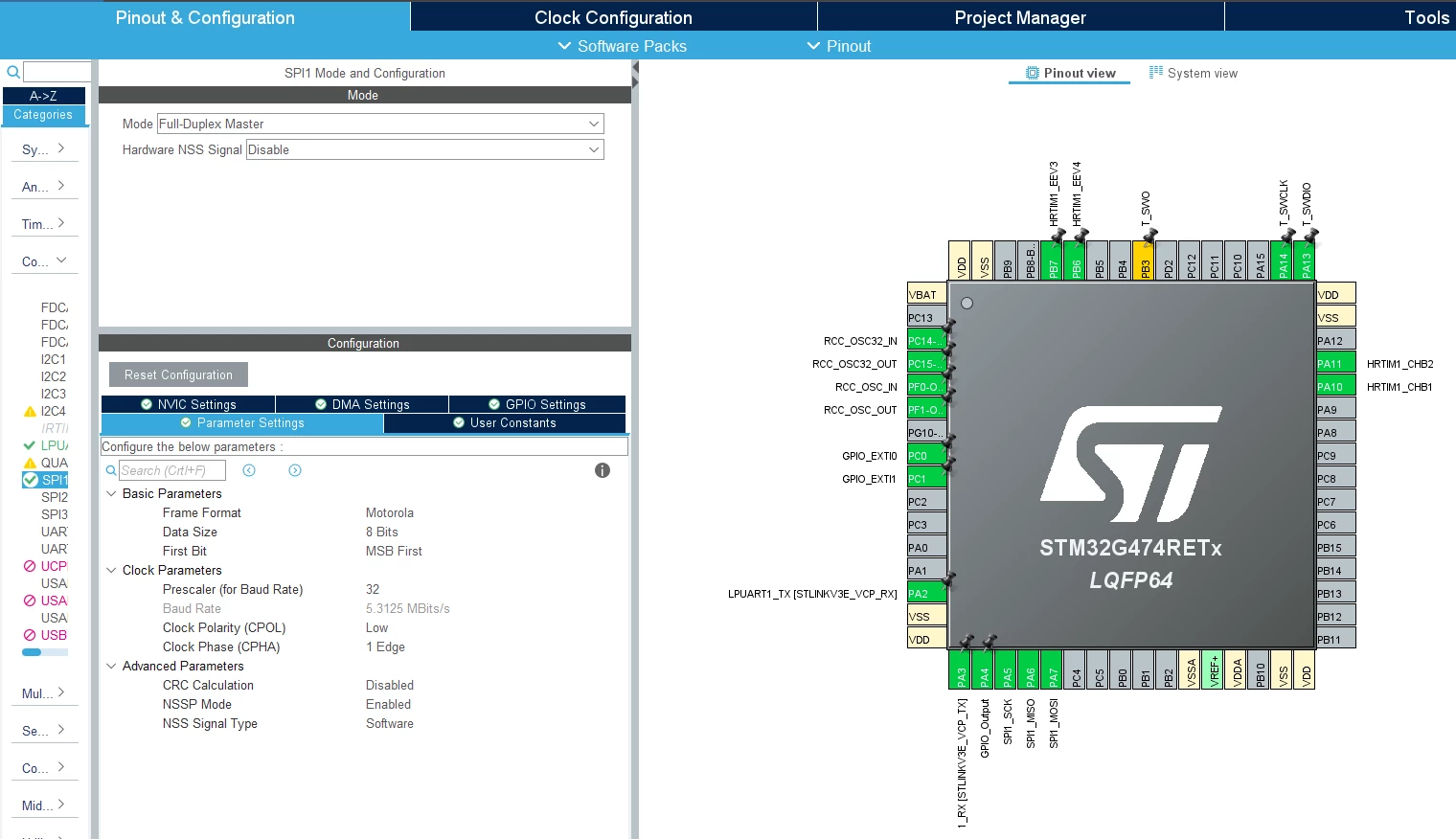

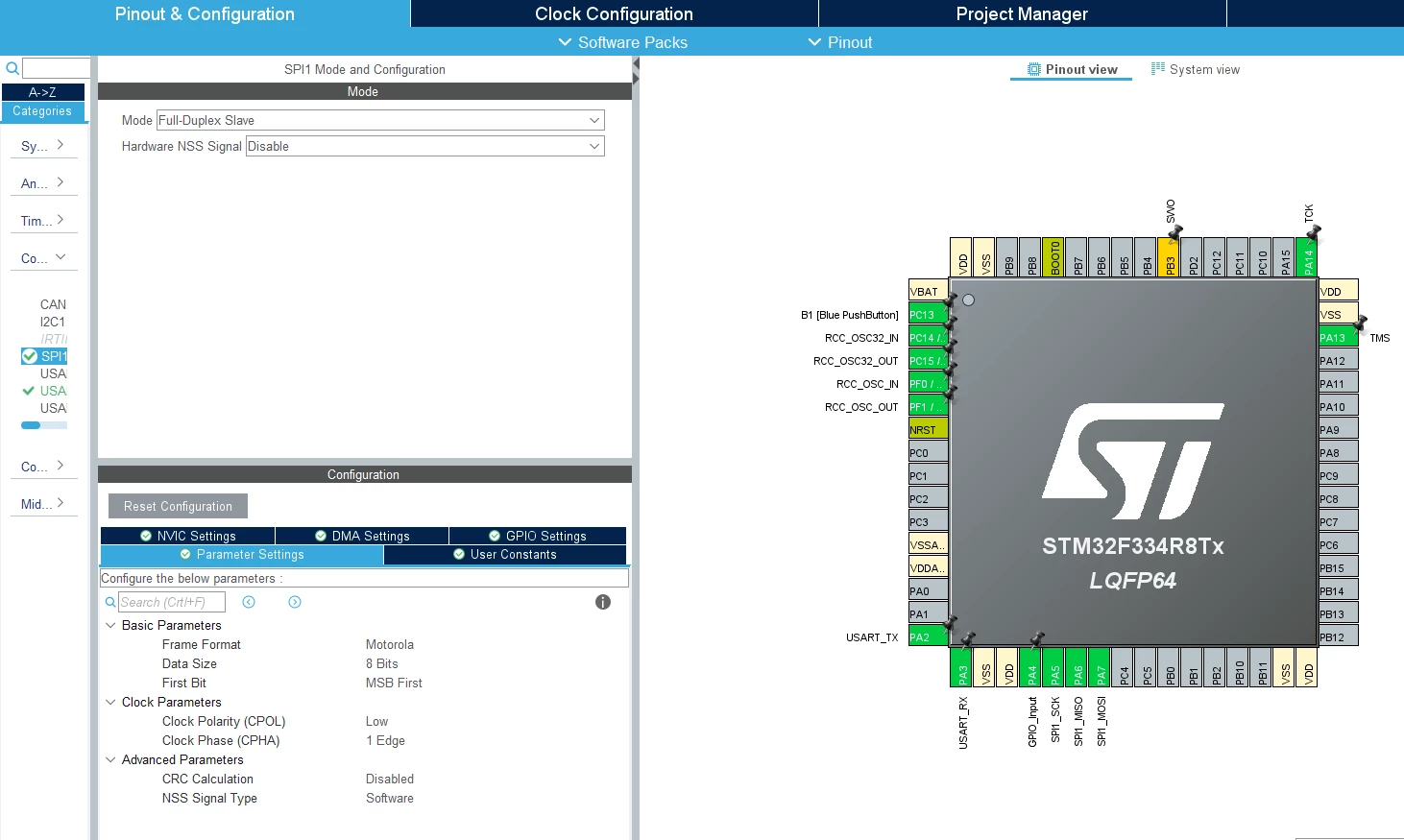

And the configuration of the slave SPI:
The master side is of course configure the same way:
I think this is a programming issue but I don't get which one.
