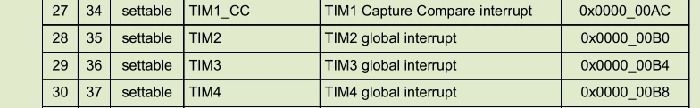

I want to set interrupt priority for TIM3. So I made configuration in NVIC register.But I met some question.the base adress of NVIC in STM32F10xxx Cortex-M3 programming manual is 0XE000E100 ,but in another book STM32F10xxx Cortex-M3 programming manual is 0XE000E000,that really made me confused. the position of TIM3 in the vector table is 29.so which NVIC_IPRx should I use.IPR 7 is right ? and what's its adress ? I'm using assembly language not C language. Thank you.

TIM3 would be BIT 29, BYTE INDEX 29, right?
The NVIC base is 0xE000E100

Vector Table entry address VTOR + 0x40 + (29 * 4) -> 0x080000B4
