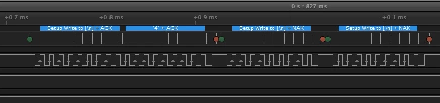

the problem is when master send the first byte, which is the length of the next word, Nucleo acknowledge receive but then it does not acknowledge of the next coming byte as shown in Picture from logic analyzer
Thank you for any suggestions
