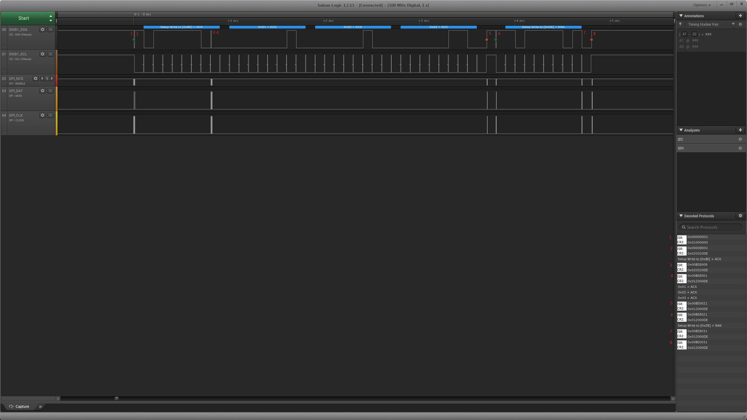

The issue is that setting the START bit to request a new master transmission becomes latched into the hardware peripheral during a bus collision where itself is addressed and the peripheral changes to slave receiver to receive a message, and it cannot be aborted!  Immediately after the STOP condition is detected, the I2C peripheral will try to send a START + address (which will likely be incorrect), even if the START bit is cleared by setting the ADDRCF bit.
There is no way to abort this transfer without resetting the peripheral.
  See workarounds below.
The reference manual for the STM32L4 series RM0394 on p.1037 and p.1071 indicates that setting the ADDRCF will clear the START bit that is pending.  This does clear the START bit, but does NOT clear the pending START request in the hardware peripheral.  The documentation needs to be updated to make that clear.
Steps to reproduce
I have attached a demo project that reproduces this bug, but here is a more verbose explanation:
  1. Setup I2C peripheral with OAR2=something, ADDRIE=1 (so that we may be addressed as a slave) and start a master transmission by configuring the DMA and setting STOPIE=1, TXDMA=1, AUTOEND=1, RELOAD=0, NBYTES=N, START=1.
  2. At the same time, or a few microseconds before, have another I2C master address this device as a slave. This bus collision is not detected as an arbitration loss (ARLO) when it is during the address phase. The I2C peripheral is automatically configured as slave and the ADDR flag is set.
  3. When the ADDR flag is set, reconfigure this device for slave reception by configuring the DMA and setting STOPIE=1, SBC=1, RXDMA=1, AUTOEND=0, RELOAD=1, NBYTES=N+1 (anything greater than before). Then set ADDRCF=1 to clear the pending ADDR bit and ACK the address to start. This also clears the START bit in hardware... but the START request is still pending in hardware!!! (this appears to be the root cause of the bug)
  4. After the transfer is complete and the STOP condition is received, this I2C peripheral exhibits the bug: a START condition is asserted on the bus, and the original slave address set in step 1 is transmit on the bus, even though the START bit has been cleared for the entire last transmission.
  5. In addition, if we try to work around the unexpected START+address transmission by setting up the TXDMA, it turns out that the NBYTES=N+1 was latched into hardware, so overwriting it with NBYTES=N does NOT have any effect.

Logic Analyzer Capture
See attached screenshot (001_Pending_START_ADDR.png) for an illustration of the problem.
