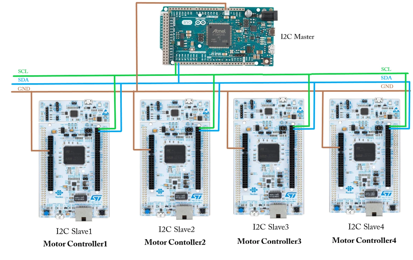

What I doing right now is, use 1 Arduino Due as master to communicate with 4 STM32 boards, which I have set to fast mode(400kHz) and each has an different I2C ID(31,32,33,34), like this

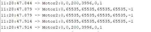

1 Arduino communicates with 1 STM32 bord is ok, everything correct, but when I test with 2 STM32 bord, it become strange, the data got from STM32 sometimes is correct, but most of time is totally wrong, shown in the following picture0690X000008ibExQAI.png

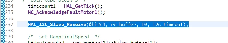

the first and fifth line is exactly what I want, but the other is complete wrong. And I have found that , when I change the I2C timeout in STM32 0690X000008ibIQQAY.png0690X000008ibIVQAY.pngor the delay time at the end of the Arduino code, it can also effect the I2C communication. Is anyone kown why?
