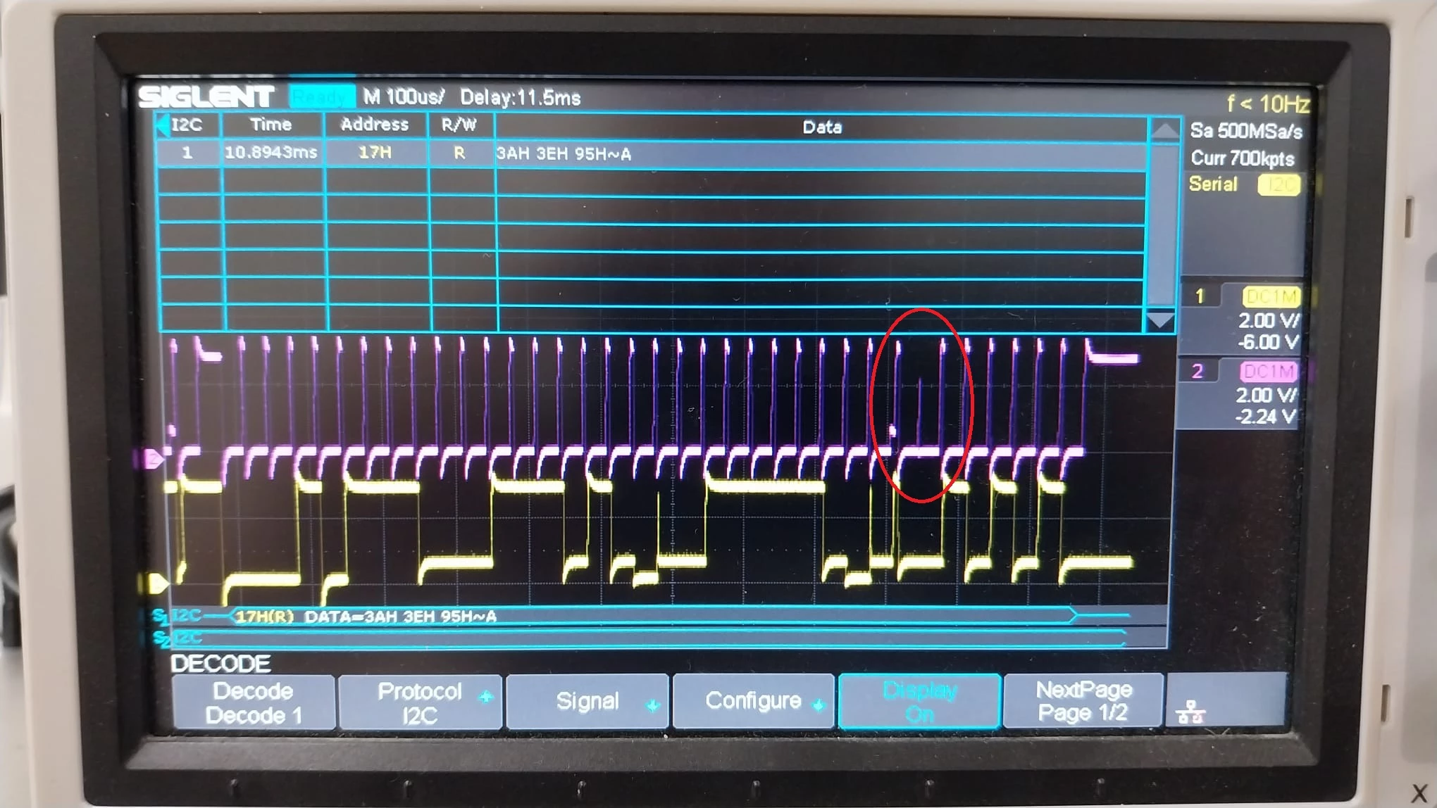

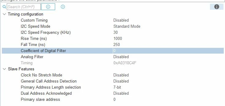

I'm developing a product using the STM32G030C8T6. I set the I2C using the STM32CubeMX (settings attached) and used the functions supplied by the LL library. The I2C is set as Master and I only have one Master and one Slave on the bus. I manage to transmit and receive but sometimes, one of the clock pulses have a much shorter period which is causing Arbitration or Bus errors. I attached an image showing what I described. Does anyone has an explanation of why this could happen?

The hardware is custom made for the application. I only have one master and one slave and the slave is a battery with SMBus. They are connected through wires. A 2.7k pull-up resistor on the Master side and a 200R resistor in series between the Master and slave.
I doubt its a failed clock stretching. Clock stretching is happening on the clock pulse right before the failed one, you can see the ~0.6V step before the pulse. Also, due to the series resistors and wires, when the slave stretches the clock, the bus voltage is around 0.6V. The failed clock is seen to go back to 0V which indicates that its actually the master who is prematurely pulling the clock low. Any ideas why the master could do this?

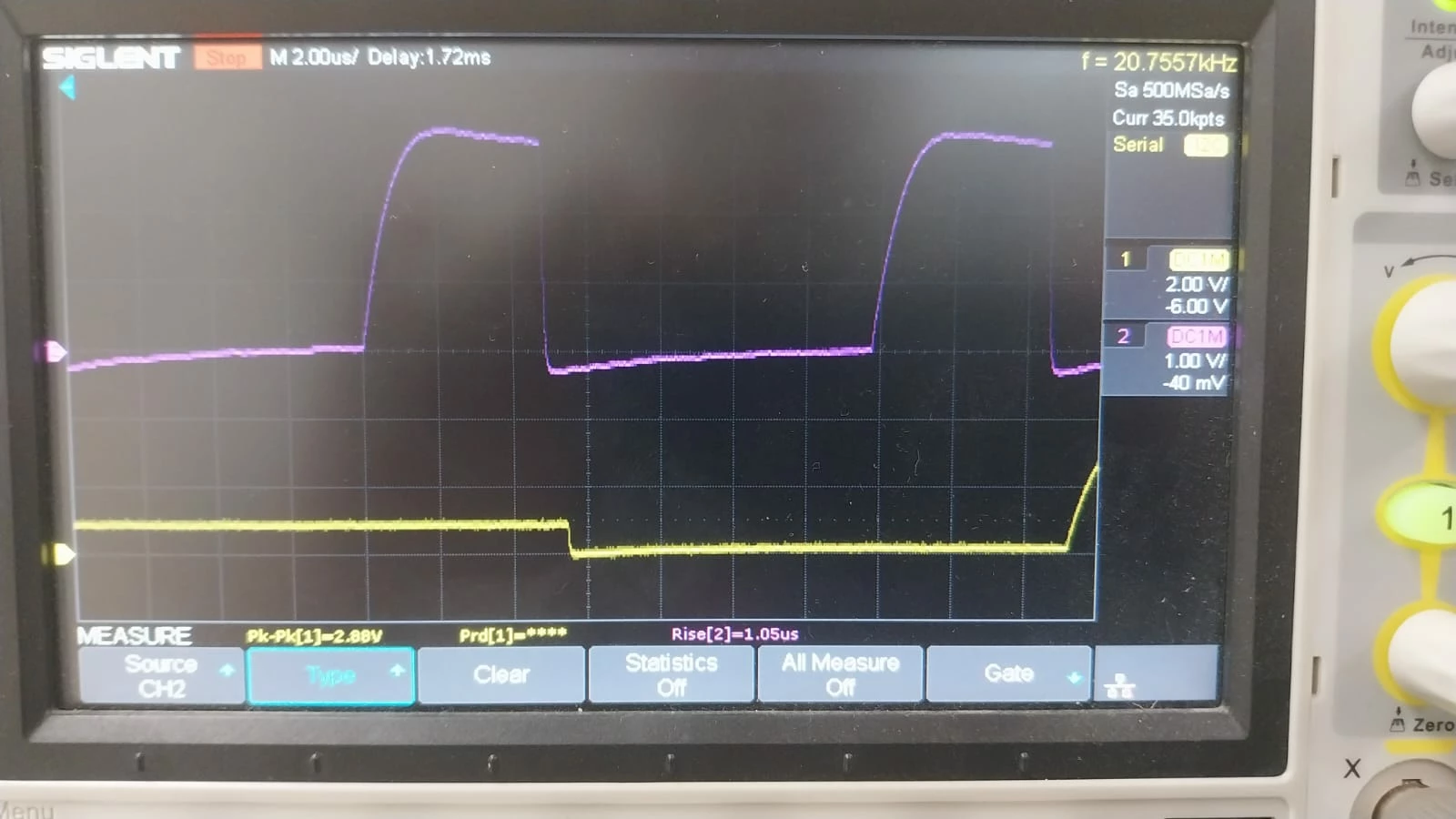

I measured the clock rise time (attached) and it is in the range of 1us (1000ns) as set in the I2C settings. Shouldn't this be good?

In any case, I have confirmed that the issue is the rise time. The slave which I was using is a product which was developed years ago and incorporates into it two slave devices, one of which was the one slowing the bus. I got another version of the same product without the slave which was slowing the bus, and now having a rise time of ~260ns. The issue disappeared completely.

As a side note, I kept increasing the SCLDEL value in the I2C_TIMINGR register and, even though it improved slightly, the issue still remained. In keeping on increasing the Data Setup Time value, I'm feeling I'm just walking blindly as I still haven't managed to relate this value to the tolerated rise time. Again, I think the accepted rise time can be modified given that the STM32MXCube accept rise time values as parameters for the I2C settings.

@PieterInHetBos @Bob S The slave I am communicating with is a smart battery with SMBus. I went further into its schematic and found that it has 68pF caps on both the SCL and SDA lines (for some reason, who designed this battery thought they would be beneficial ?!?!? ). So it turns out that the issue is not due to the slave chips. Nonetheless, a lot of customers already have these batteries and the product I am developing should be able to communicate with them anyways.
I have tried also using 1k resistors but the issue persists. Decreasing further the resistors will cause another issue due to the series resistors in the bus on the slave side, ie, when the slave pulls the bus low, a potential divider is created between the pull-ups and the series resistors. Thus, the smaller the pull-up value, the higher the potential level will be during logic '0'.
