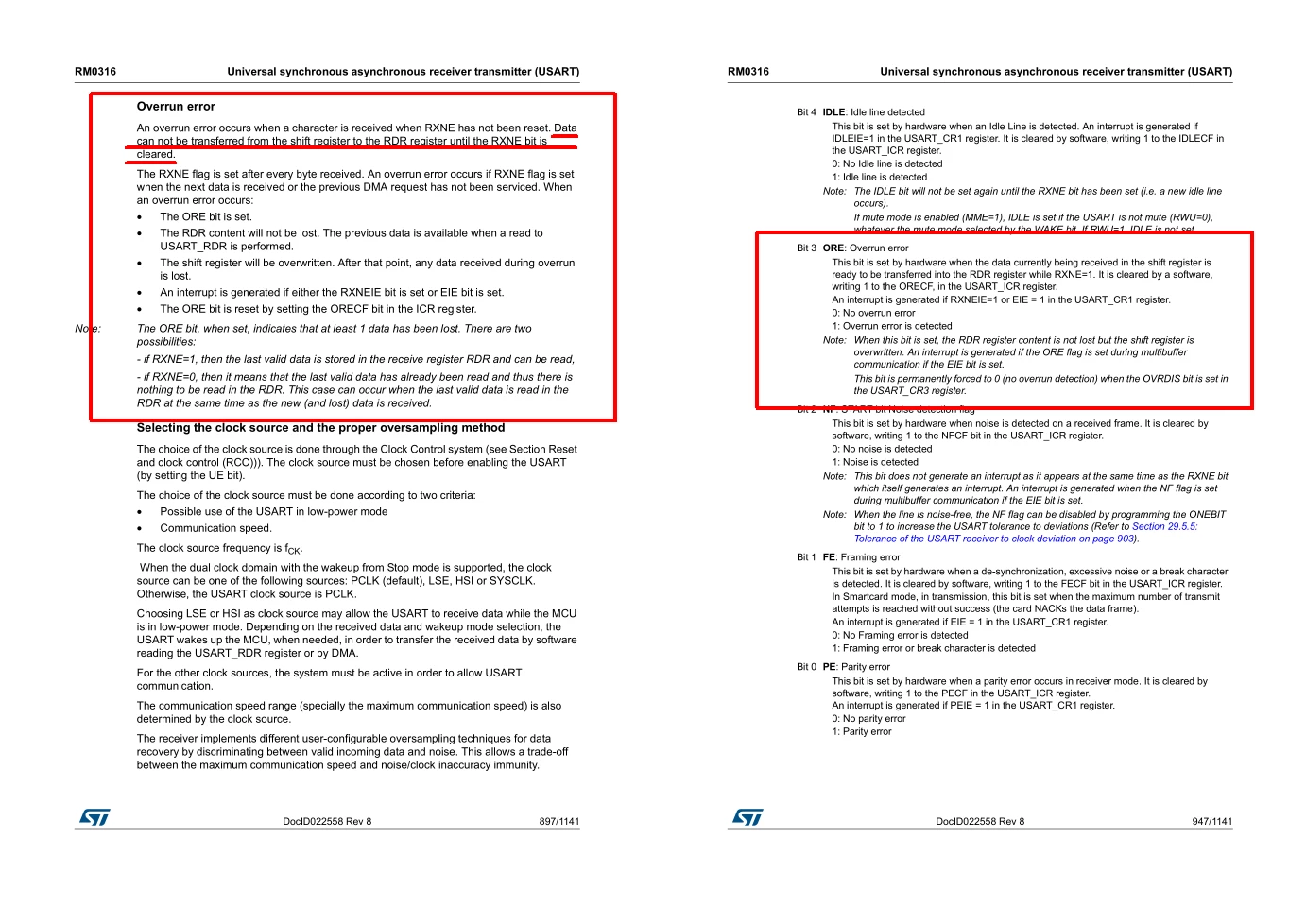

Watch for overrun condition. It can block reception.
DBERG.1
DBERG.1Author
Jan 2, 2023 1:46 PM UTC
Thanks.
How do I check that?

Overrun detection reports interrupt latency failure. Suggest to use LL low layer for uart communication to reduce WCET.

With the UART's it's usually better to service very quickly, most STM32 only have a single byte buffer for each direction, and the interrupt isn't going to be re-entrant (won't pre-empt, and all the UART1 interrupts come through a single vector).
Do your work quickly and leave. Buffer data. Process when the execution time is not critical, it's easy to get distracted decoding and processing the stream in the interrupt.
The interrupt / callback are done in interrupt context.
Most STM32 interrupt for every single byte, regardless of what you do with HAL_UART_ReceiveIT()
Observe and clear pending error status (ie Noise, Overrun, Underrun, Parity, Framing, etc) when you dispatch new data to a buffer, and when handling the interrupt(s)

@DBERG.1​ The problem is not overrun but how you're using HAL_UART_Receive_IT incorrectly
For UART2, I see that you don't even look at the HAL return status. Once HAL_UART_Receive_IT does not return HAL_OK, then that UART port will no longer receive an interrupt. HAL returns HAL_OK or HAL_BUSY where the latter is the most common when UART stops receiving data. That UART port is now dead in the water. There is HAL_ERROR but that is a very rare case.
I assume in the other reading functions you're calling HAL_UART_Receive_IT but also not looking at HAL return status?
What you need to do is set an error flag so you can then later in a polling routine, try to enable interrupts again for that UART port when HAL is not busy.
Here is some code snippet so you can see how the error flag comes into play to make sure receive interrupts always gets enabled.
