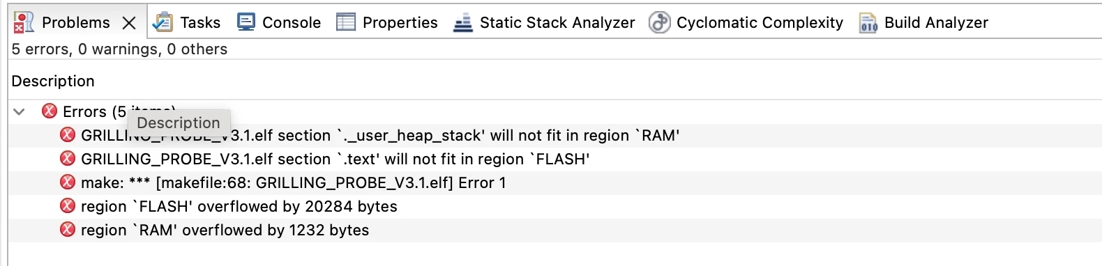

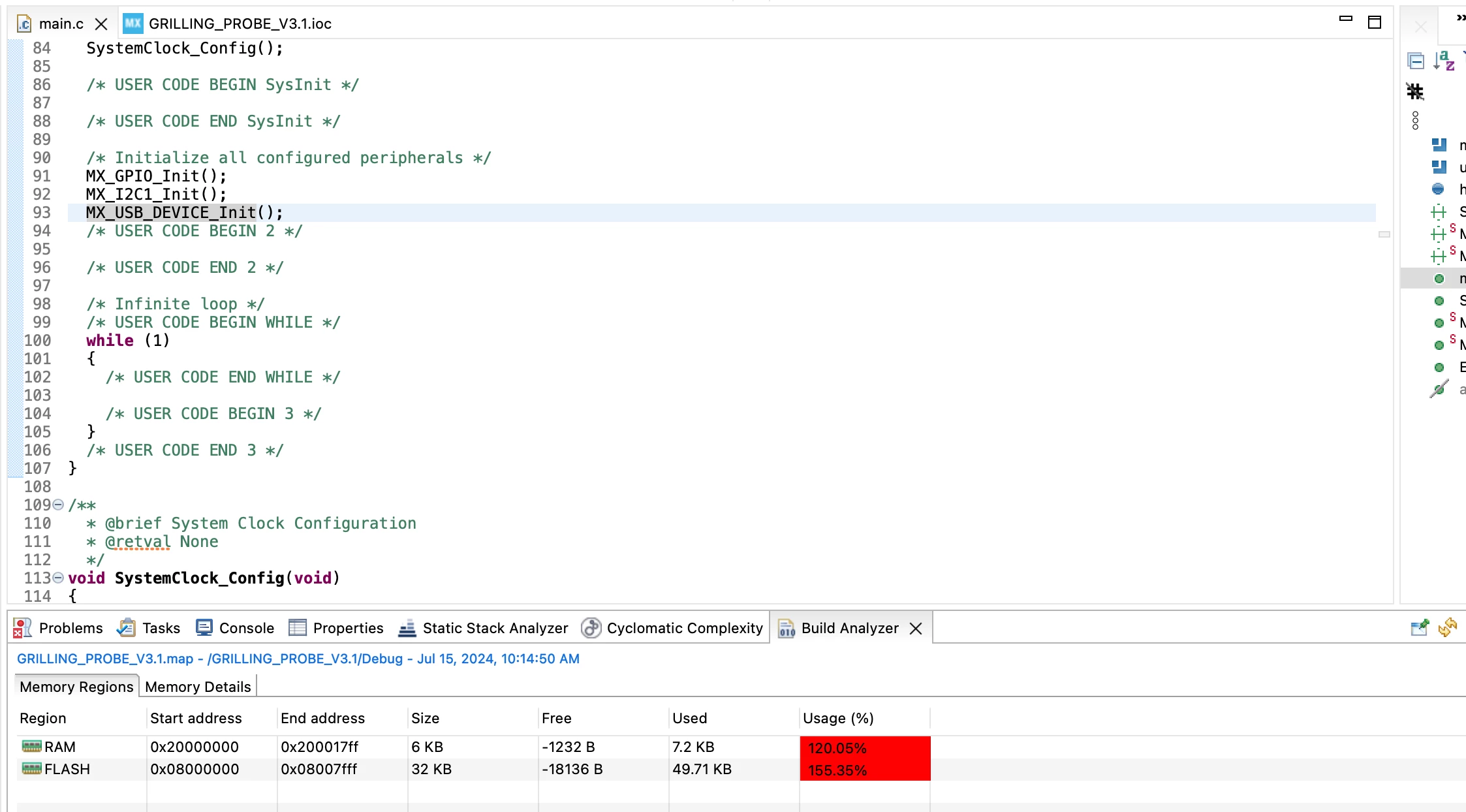

I am using a STM32F070F6P6 microcontroller for a very basic/simple project to help learn the STM32 platform, etc.
I am getting an error when I attempt to build my project that my code overflows FLASH memory by quite a bit.  I did a test on a new project, and even without any personal code of my own, if I try to compile the exact same build, the USB middleware overflows my FLASH memory by a ton.  I am only using I2C and USB peripheral in my project.
Does this seem abnormal? Am I doing something wrong?  It doesn't seem right to me that these add-ins themselves should be enough to overflow the FLASH memory size when I haven't even written a single line of code.
Are there any steps you usually take to optimize the code?

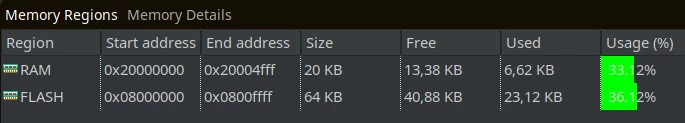

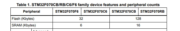

>Why is 32KB not a clever decision for USB?
F07x can have 128K + 16K :
This is ok for using USB , but still a "small" cpu for such use .
I just tried using a F103C8 , 64K flash + 20K ram. (I would say: minimum for simple USB , like CDC device.)
It needs (with -O2 ) : (all ram i use is about 8 byte, for test CDC , send: "check ! \n " )
If you wanna play the "can i get USB device with 6K ram running" game  - ok, maybe using other USB stack, it could work.
see or try: https://github.com/hathach/tinyusb

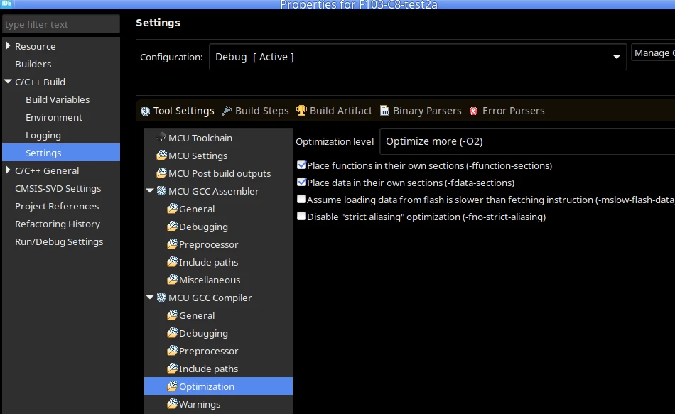

try : set optimizer -O2  , in IDE -> project-> properties
see:
For F103 with USB->CDC device i get 23KB flash used.
btw  just a 32KB cpu is NOT clever decision for anything like USB ...

Watch also if anything pulls in the floating point libraries, these too can have quite a large up-front cost.
You might want to try building with the Keil MDK, there's a free license for STM CM0(+) parts and you might be able to play games with optimization, dead code removal, and link time optimization. LTO is a multi-pass compile/link, which again tries to identify dead code, and the minimal working set.
