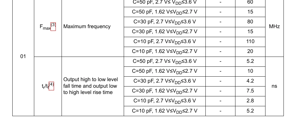

SPI on H743 can have a clock up to 100M :
If pin speed set to very high , pin will switch fast - really fast :
110M , but at 10pF load ! So if you connect your (standard ? ) probe, at 10:1 setting, it will add about 10pF load to the pin/line....You cannot measure it with a standard probe and a scope.
Just believe the ds: it IS switching at ~ 3ns rise/fall times, but your connection has to be short, damped with a series resistor and low capacity...if you connect a cheap standard probe - its "game over".

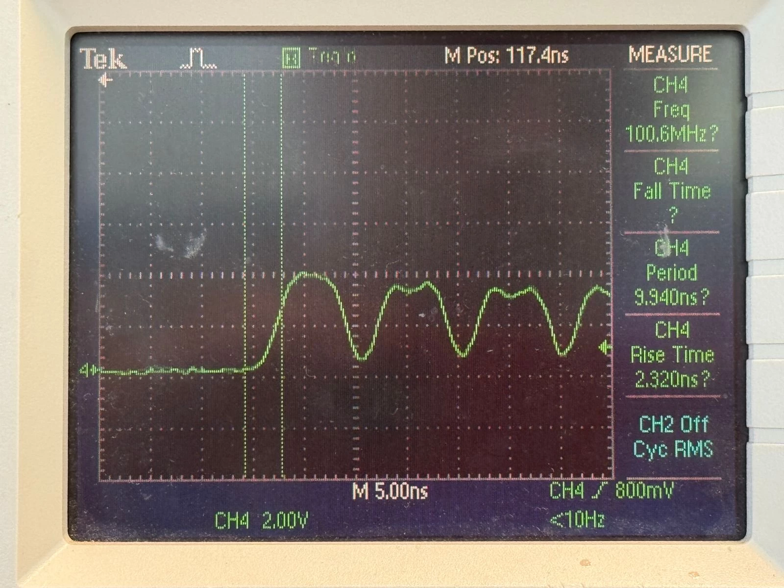

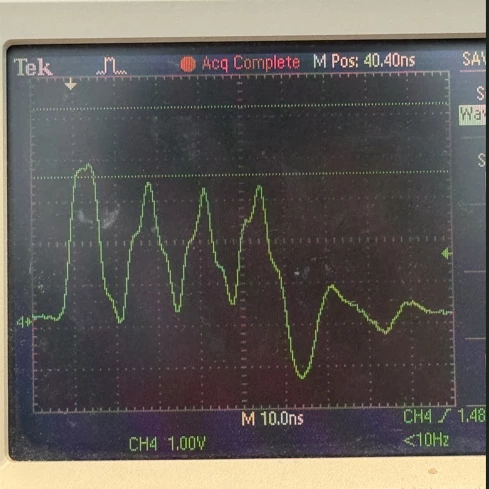

I'm working with the H7S3L8, also, my digital oscilloscope is 200 MHz rated, using a 10:1 probe also rated for 205 MHz, so I believe in terms of capacitance this should be within range. I even tested this with a 500 MHz rated scope.
I added a 100 Ohm resistor to the load and I am able to see a more clean signal at 100 MHz, but the fall and rise time are still an issue.
I agree that datasheet specifies the performance conditions, but my testing probe seems to be within the bounds of the specification. So, considering @TDK's comment as well, could the traces on the board be adding enough capacitance to see such a decrease in the signal's quality and time response?
Thank you for the help.

Sep 11, 2025 7:06 PM UTC
Yes, a resistor, which does diminish the overshoot.
We ran a couple more tests by actually cutting off one of the lanes and testing directly at the chip's output. This resulted in observing much better rise and fall times and evidenced the circuit's susceptibility to capacitance.
Thank you everyone for your responses.

>I am able to drive the signal at 40MHz and still get a decent square signal
Fine, so you know: your probe+scope working fine at 40 MHz , square wave = to see a 40M square, you need at minimum 3. and 5. harmonic, thats 200MHz !
So everything fine - except your expectation, to live not in our universe and its physics.
To see something like a 100MHz sine, you can use your probe+scope , as this is in its capabilities.
For 100MHz square, at least with 3. and 5. harmonic, you need a > 500MHz probe+scope.
To see a real good square, need 9. harmonic minimum, so a > 1GHz probe+scope would be needed.
And ultra low capacity probe, with < 20mm wires signal AND ground to probe...really difficult and expensive.
OK now , understanding ?
