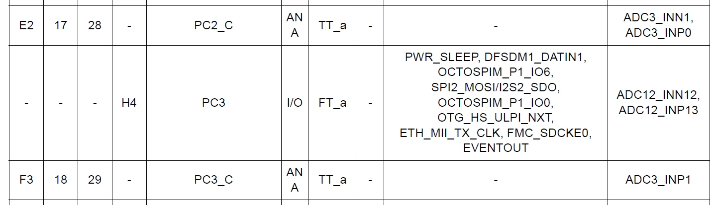

i am using stm32h723zg nucleo board, I'm using adc's direct channe, There are 2 different analog channel definition processes for the direct channel.what is the difference between the two.

PC2 and PC2_C are potentially separate pins. The latter has a direct path to the ADC and allows for faster sampling, with some drawbacks.
0693W00000GZwOUQA1.pngSome chips, such as the one on this board, only have a PC2_C pin broken out. On these chips, if you want to use the ADC3_IN0 function, you do not need the switch closed. If you want to use functions of the PC2 pin, you need the switch closed so that the physical PC2_C pin is connected to PC2. The switch is closed by default.

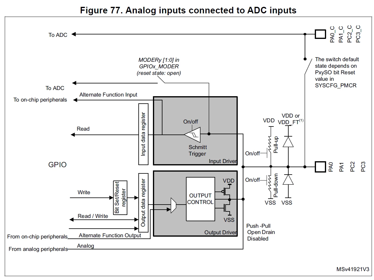

0693W00000GZwOeQAL.pngPC2_C is always in analog mode and needs no initialization.
If the switch is closed, you are increasing capacitance on the line which can reduce noise (and accuracy).

thank u your ansever.What is the disadvantage of direct channel?
December 3, 2021
Less protection on the pin. And there are fewer of them.
