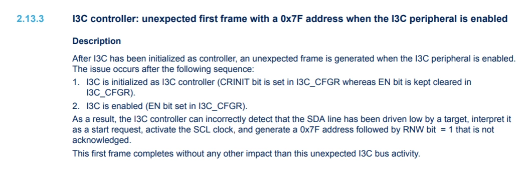

When consulting the errata of the H533RE it states the following:
This was not happening. So I tried calling the function HAL_I3C_Ctrl_DynAddrAssign_IT(&hi3c1, I3C_ONLY_ENTDAA) twice, just in case the Target was set to ignore this first 7E.
The second time I send this instruction, 7E, the target acknowledges it and the communication flows.
Any comments or other thing I should bear in mind at the time of working with the I3C peripheral?
