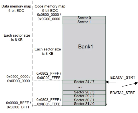

May 13, 2025 6:06 PM UTC
@Chaima_M Thank you for the help! I just had one quick question from RM0481. From my understanding, using high cycle flash relocates the last few sectors to a different memory location which is what I was confused about. For context, I know that the flash memory in the H533 starts at 0x8000000 but then what is the 0xC000000 right under in the following diagram. Are the hex values after the slashes for some other 512KB model?

May 14, 2025 10:00 AM UTC
Hello @mahirmahota ,
The address 0x0C00 0000 represents the start of secure flash memory region, while 0x0800 0000 indicates a non-secure region.
