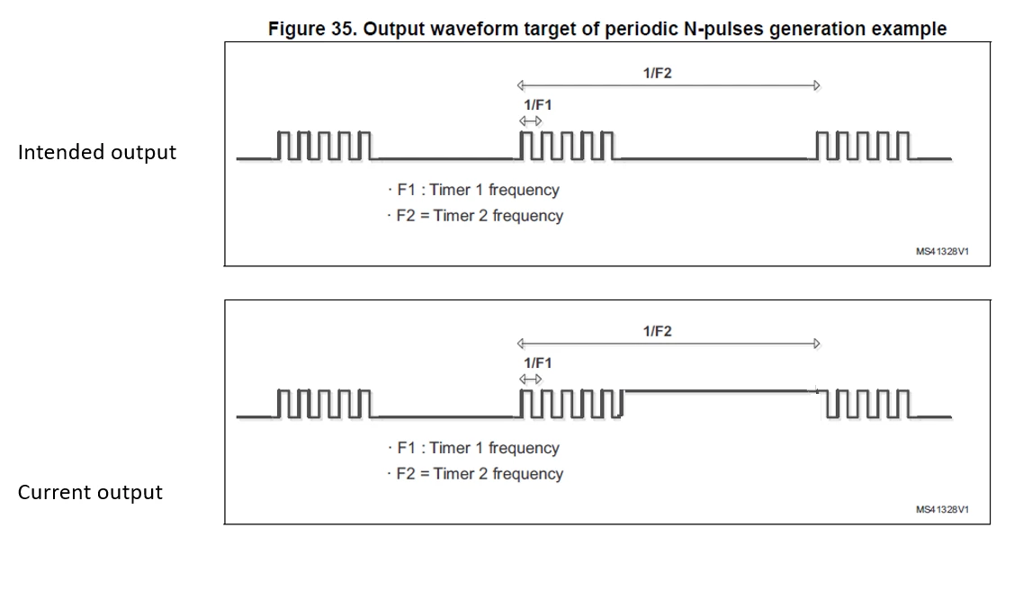

Hi everybody,
I'm trying to test the examples of the General-purpose timer cookbook (AN4776) with a STM32 Nucleo-F446RE board and a breadboard with LEDs and resistors.
This is my first time to use timers for PWM.
I copied and adapted the code of chapter 3.2 and it is working as described:
The timer TIM1 is counting up until reaching the value of CCR1 and changes the GPIO output level from LOW to HIGH until it reaches the value of ARR. The counter starts again.
The most interesting code lines are:
  • TIM1->CCMR1 |= TIM_OCMODE_PWM2; // see reference manual on page 505: In upcounting, channel 1 is inactive as long as TIMx_CNT<TIMx_CCR1 else active. In downcounting, channel 1 is active as long as TIMx_CNT>TIMx_CCR1 else inactive.
  • TIM1->CCER |= TIM_OCPOLARITY_HIGH; // see reference manual on page 510 CC1E

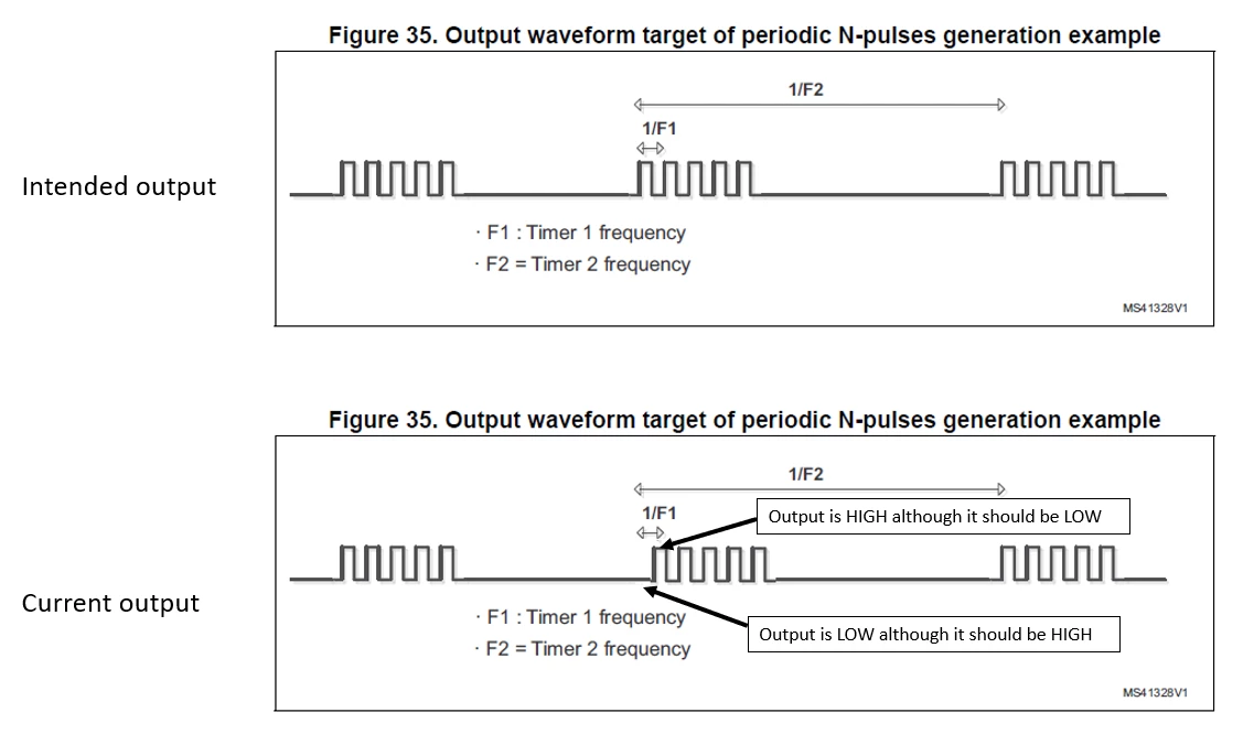

Then I tried the code of chapter 6.2. The intended behavior is that TIM2 triggers TIM1 and the output is HIGH until CCR1 is reached. Then the output change back to LOW until ARR is reached. This is repeated (value of repition counter) and after the last repeat the output remain LOW.
But when I tried the code with my board it does not work as intended. When testing it with my board TIM1 is counting up until CCR1 and change the polarity from LOW to HIGH (so the opposite of what is intended) until ARR is reached. Then the polarity changes back from HIGH to LOW and when reaching CCR1 the polarity change from LOW to HIGH and so on. If the last pulse is send (repitition counter) the output polarity is LOW until TIM2 triggers TIM1 again and start the counting.
So the output is the same as in chapter 3.2 although the example of chapter 6.2 uses PWM mode 1 (In upcounting, channel 1 is active as long as TIMx_CNT<TIMx_CCR1 else inactive. In downcounting, channel 1 is inactive (OC1REF=‘0’) as long as TIMx_CNT>TIMx_CCR1 else active (OC1REF=’1’).
This is my code:

I connected a resistor (330) and an LED in series to GPIOA_8.
I also configured a third timer with an interrupt handler to toggle a second LED to see when TIM2 (master) start counting.
Can anybody help me please?
Please find attached the code and a screenshot of the current behavior of chapter 6.2

waclawek.jan
June 9, 2019
Yes, but you do
> TIM1->CCER |= TIM_OCPOLARITY_LOW; //TIM_CCER_CC1P;
and as in Cube,
#define TIM_OCPOLARITY_LOW                (TIM_CCER_CC1P)
it means you set CCER.CC1P, which means, the output on the pin is inverted version of OCxREF, i.e. low while CNT < CCR1 and high when CCR1<= CNT <= ARR - and this is what you observed.

Hi @Community member​ ,
thank you very much for your reply :smiling_face_with_smiling_eyes:
About PWM mode 1: I found the same in the reference manual on page 510 as you described. So I agree that I have to change the Capture/Compare 1 output polarity to high (the initial value is all zero of the register so I don't need to write a value or am I wrong? Please apologize but this is my first projekt with a microcontroller). But it is the oposite of what is written in the timer cookbook (maybe a mistake in the file).
The good news is: the output polarity is high while CNT < CCR1 and low when CCR1 <= CNT <= ARR.
The bad news is: after TIM1 reaches the value of ARR and waits for the next trigger of TIM2 (master) the output polarity change to high while idleing :crying_face: . I thought if TIM1 finishes the output gets disabled and the output polarity is low as described in figure 35 in the timer cookbook. So how can I fix this?

waclawek.jan
June 9, 2019
Maybe you misunderstand the meaning of TIMx_CCER.CCxP - it does not define an absolute polarity; contrary, it simply switches on an invertor between OCxRef signal (i.e. in case of some of the PWM modes, output of the CCRx vs. CNT comparator) and the output pin. Look at the Output stage of capture/compare channel figure in the timer chapter - the function of CCxP bit is quite clear from that diagram.
In other words, PWM1 with CCxP=0 is exactly the same as PWM2 with CCxP=1, and vice versa, PWM1 with CCxP=1 is exactly the same as PWM2 with CCxP=0.
This sounds like a redundancy and it indeed is, until you get into the more complex settings of the advanced timers. Even then it does not make much of a difference, but don't ask me why is it so, I did not design the thing.
So, if you use sasy PWM1 and CCxP=0 and the one-pulse mode (repeat or not), the timer ends up "parking" after the last rollover, ie. with CNT = 0; that means, TIMx_CNT<TIMx_CCR1 => OCxREF=1 => output pin is high. So you were happy with PWM2 or inverted PWM1 after all?
