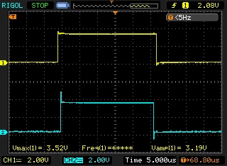

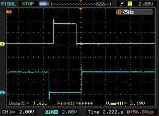

1) Both PCBs have same configuration for power stage - high side active low, low side active high
I just use compiled firmware from
STM32F303VCT6

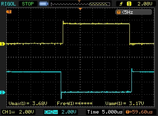

 in STM32F303RBT6 and have really strange behaviour od deadtime logic:
- in STM32F303VCT6
 deadtime works as expected. Yellow high side pulse switches from active (zero) to inactive(''one'') before blue low side pulse switches from inactive (zero) to active active (one)
- in STM32F303RBT6 same firmware gives me ''inverse'' deadtime.
Yellow high side pulse switches from active (zero) to inactive(''one'') after blue low side pulse switched from inactive (zero) to active active (one). It's really bad situation, which will damage power stage under normal conditions

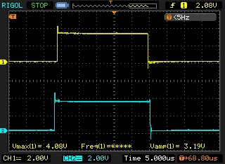

2) I tried to test firmware with both high and low sides ''active high'' configuration (I turned off power stage power supply). With this configuration both controllers work correct - there is deadtime beetween pulses
- Both ''active high'' sygnals for STM32F303VCT6
- Both
STM32F303RBT6

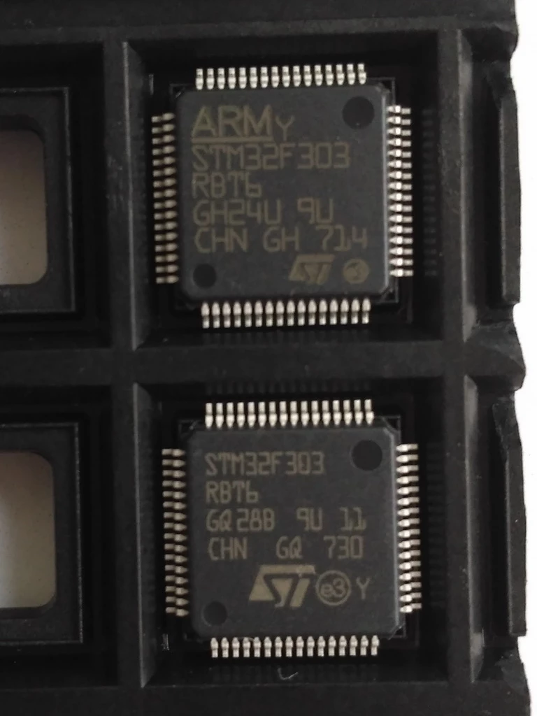

3) I tried this firmware with 2 different STM32F303RBT6 rev Y: one I've bought from Arrow.com few days ago, and second from my local distributor in Ukraine. The behaviour is same for both mcu's.
Here are my mcu's - first from local distributor, second from arrow.com
Maybe the problem is in firmware, but why same firmware has different behaviour in same family of STM32F303? Is the difference only in form-factor, or not?

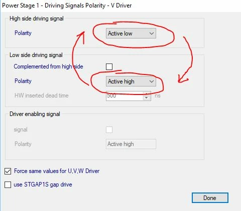

2) Modify you Motor control workbench project in part of power stage - you should inverse polarity of high and low side of power stage. For example, for my project:
Before:
After modification:
That's all - now you can use your PCB with wrong routing without changing electrical connections.

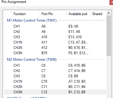

I've found, that problem not in deadtime at all.
According to ST Motor Workbench I should connect PWM signals with this map:
I don't know why, but in STM32F303RBT6 mcu firmware swaps high side with low side of power stage. My PCB works only if I reconnect top side signals to low side of power stage driver, and visaversa - low side signals to top side of power stage driver
My correct working connection map is (I tried it for motor 2 - TIM8):
CH1 - C10
CH2 - C11
CH3 - C12
CH1N - C6
CH2N - C7
CH3N - C8
It seems that my mcus have swapped OCx and OCxN of TIMER1/TIMER8.
Is it problem in FOC SDK, or it's error inside silicon of STM32F303RBT6 series?

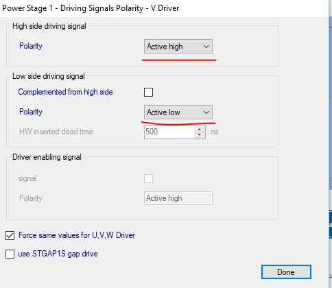

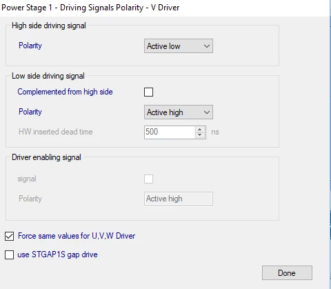

Before:
After modification:
