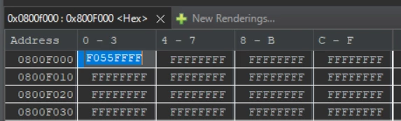

I was trying to emulate eeprom using flash memory. I am using Nucleo-F030R8 board. I was able to program flash 2 times (0xF055 was the test value):
however I cannot reproduce it anymore and whilst trying to program I get PGERR.

Hi @Jouls, and welcome to the STCommunity !
You are trying to write again at the same address, and @Bob S is right about the fact you can't overwrite an existing value in the flash.
You can fin the explanation in the Reference Manual :
The flash memory interface preliminarily reads the value at the addressed main flash
memory location and checks that it has been erased. If not, the program operation is
skipped and a warning is issued by the PGERR bit in FLASH_SR register.
You can either write to a new location, or erase the current sector of the flash using the HAL function :
FLASH_PageErase(PageAddress) (you can find this function in the file stm32f0xx_hal_flash_ex.c).

I've never used the F0 series, but in general you can't write to any FLASH location more than once without erasing the entire sector of FLASH in between writes.

You were right! Thank you all for help.
