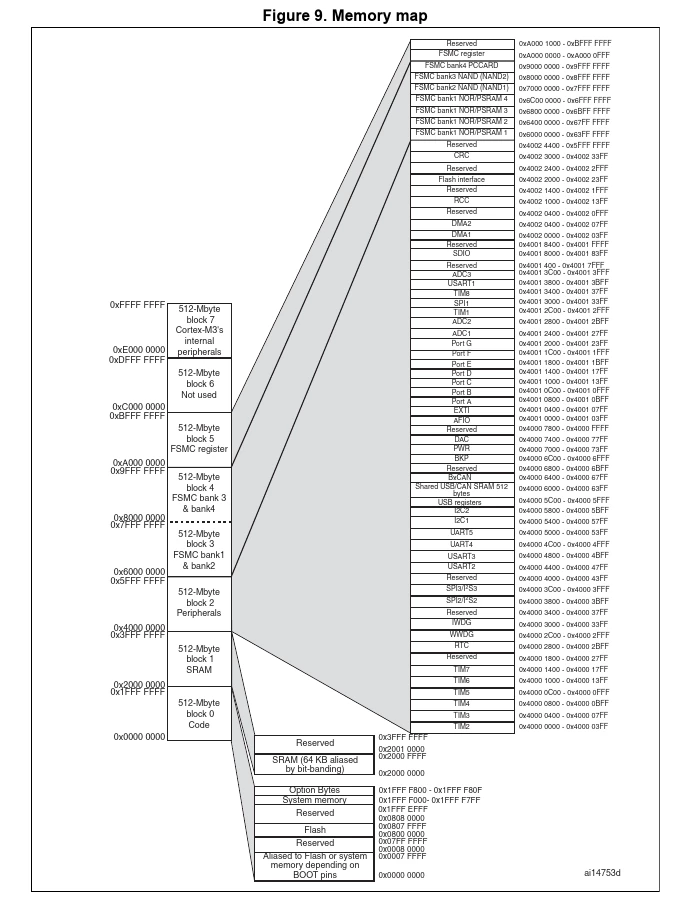

AScha.3
August 2, 2024
So from ds :
And what exactly you want to  configure in Flash Memory ?
