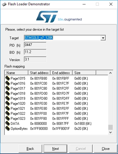

).I have written a STMap file for my device (see attached file STM32L0_x7_128K.STmap).
I have started from STM32L0_x3_x2_x1_192K.STmap file and modified the following informations :
PID=0447 (I leave the value unchanged as it was the value given by ST-Link V2)
BID=1FF01FFE (value found in AN2606 )
I have remove all the pages above 128K (as my device has 128Kb of flash memory)
I have leave the [DATA] and [OptionBytes] unchanged

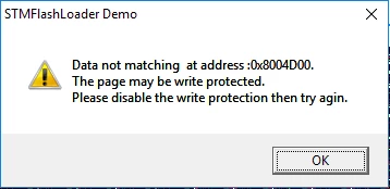

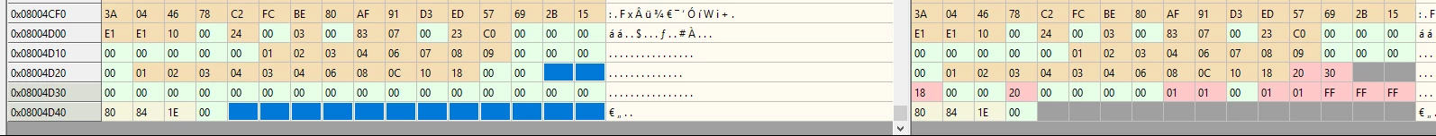

When prompted I choose my file in the demo software (STM32L0_x7_128K), the mapping is correctly displayed in the tool, and I can apparently reprogram the firmware in the device. But in fact if I select the verify option in the gui, the write succeed but the verify failed, and the program does not run. I have confirmed with ST-Link that there is really a difference.
Am I doing something wrong ? I am very surprised that the error occurs at the very end of my program while it is not the end of the flash (Can it be a software problem ?). There is no memory protection, and I can successfully write that memory location either with ST-Link or OpenOCD. Has anybody any idea to make the firmware write and verification complete successfully ?

- configuration.png : illustrate how my custom STMap file is interpreted by the demo boot loader software
- ErrorMsgBox.png : the message box opened by bootloader demo software
- MemFileComp.png : illustrate the differing bytes in ST-Link utility software
