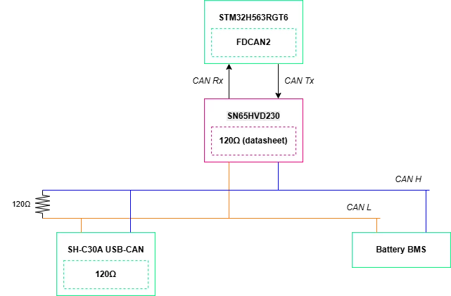

SN65HVD230 transceiver in silent mode (Rs pin connected to 3.3V) (120 Ω intergrated) wired with a single 120 Ω terminator at the far end
So, RS pin is connected to 3.3V directly or has a pull-up resistor to 3.3V?
Does the USB–CAN adapter have a terminating resistor enabled?
If so, it sounds like the STM32 terminating resistor may be an open circuit? So when you remove the USB–CAN adapter, there is only 1 terminating resistor on the far end. The USB–CAN adapter is probably the node that is sending the ACK, not the STM32.
Draw a block diagram showing your nodes, CAN bus wires, and where the terminating resistors are.

aqua_devAuthor
May 30, 2025
I have a switch that connects the Rs pin directly to 3.3V or to a 10k resistor to ground. Right now the only way it works is directly connected to 3.3V.
The USB-CAN terminating resistor is enabled, but I tried to disable it and it didn't seem to be the problem. This totally makes sense, it's the conclusion I'm leaning towards -> The USB–CAN adapter is probably the node that is sending the ACK, not the STM32.

Now many nodes are on the bus?
If it is just the BMS and the STM (when the CAN-USB is disconnected) and the STM is not able to transmit on the bus, then there is nothing to send the 'ack' bit when the BMS sends it's message and it will go error passive. A receive-only node like the STM will only receive messages that are acknowledged by another node that is capable of transmitting messages.

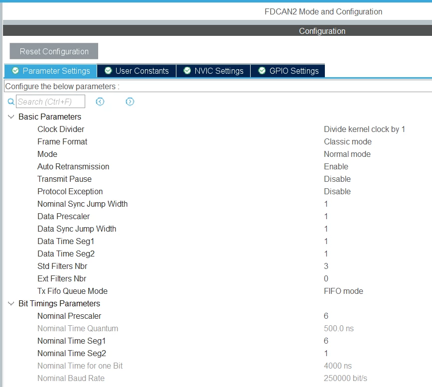

I changed to the typedef union which is practical, but does not eliminate the problem of the communication. Also I changed to HSE clock which is 12 MHz in my case so I now have different parameters for the same bitrate (250 kbits/s), but it does not seem to be the solution.
mƎALLEm
May 30, 2025
Please attach your ioc file.
Karl Yamashita
Principal
May 30, 2025
Assuming you have an external clock at 12MHz, try the attached IOC changed to use 66MHz and use the values below. I have values for 12MHz as well
 Baud 250000 bit/s
FDCAN clock freq(kHz)seg1seg2 prescaler
120003981
66000219441
If a reply has proven helpful, click on Accept as Solution so that it'll show at top of the post.CAN Jammer an open source CAN bus hacking toolCANableV3 Open Source
