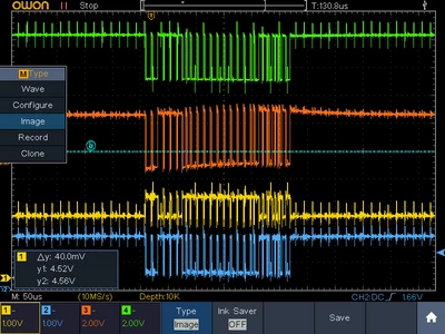

STM32 FDCAN: Frames visible on CANable (candump) but TX still reports ACK error — scope shows ACK notch
TL;DR:
  • Two-node bus: STM32 (FDCAN1) ↔ CANable (SocketCAN) at 500 kbit/s
  • candump can0 shows frames from STM32, but STM32 keeps flagging ACK error and increments TxErrorCnt.

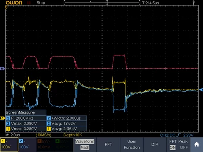

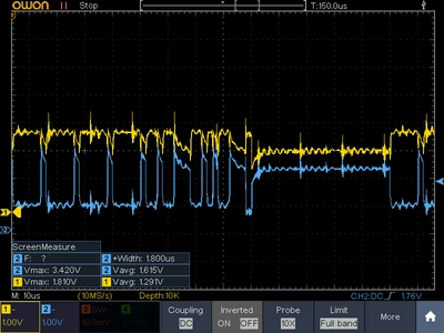

  • Scope on CANH/CANL (diff trace CH1–CH2) shows a dominant ACK bit in the ACK slot (!)
  • External loopback works.
  • Looks like my MCU isn’t “seeing” the ACK at its RX input—looking for eyes on transceiver mode pins, RX pin mapping/AF, and timing.

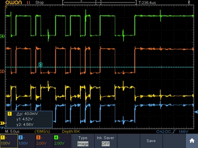

  • Scope on CANH/CANL shows clean dominant bits. The CH1–CH2 differential (pink) clearly shows a dominant pulse in the ACK slot.

Channel 1 - CAN H
Channel 2 - CAN L
Channel 3 - D
Channel 4 - R

suyog1AuthorBest answer
October 1, 2025
There was an manufacturing defect in my board. The D and R pins were shorted while the MCU was soldered IG... Anyways, I checked with the other board which did not have an short and it worked very well.
@all Thankyou for your help.
