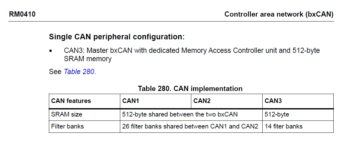

STM32-F767ZI Filter Bank Count
Hey,
I´m working on implementing all 3 CAN bus interfaces on a F767ZI.
Looking through the Reference Manual it states that dual CAN set ups feature 28 filter banks and single CAN set ups feature 14 filter banks. However looking at Table 280 it states that CAN1 and 2 share 26 filter banks and CAN3 has 14.
Is the 26 a typo or is the number actually limited on this MCU?
//Andre
KDJEM.1
KDJEM.1Best answer
Feb 3, 2023 10:11 AM UTC
Hi @AndreM​ ,
I confirm that, the bxCAN have 28 filter banks shared between CAN1 and CAN2 for dual CAN.
The 26 filter mentioned in table 280 is a typo and will be corrected in the coming release.

Hello @AndreM​ ,
I reported internally this typo.
Internal ticket number: 144696 (This is an internal tracking number and is not accessible or usable by customers).
Kaouthar
KDJEM.1
Mar 6, 2025 7:43 AM UTC
Hello @AndreM;
The issue is fixed in RM0410 Rev 5.
Thank you.
