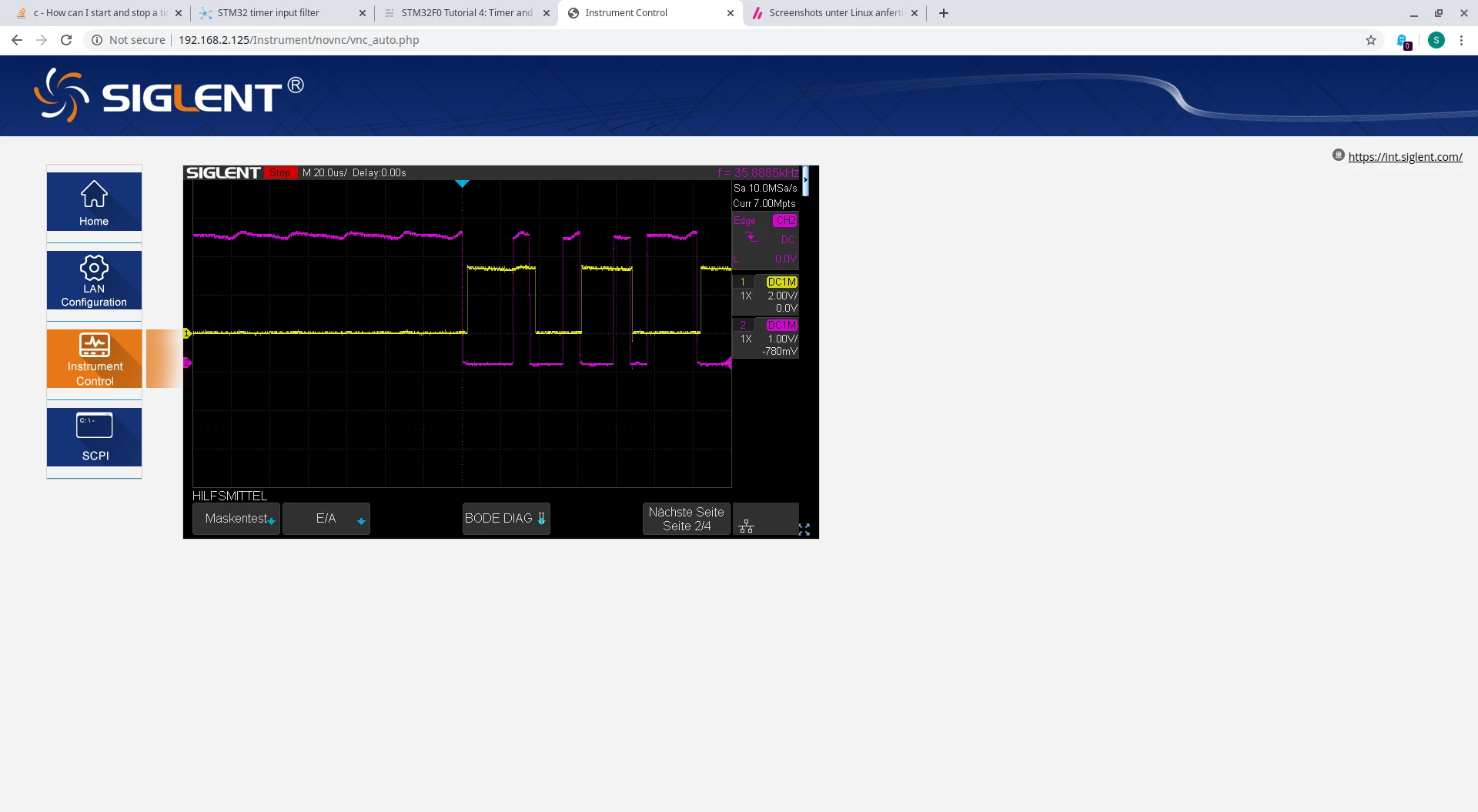

Dear community,
I am trying to use a timer to see if there is no activity on a data line. However, it works not as expected.
As you can see in the picture, the timer (yellow) gets interrupts when the signal line (pink) is changing. But no interrupt, when there is no change. I want the opposite.
See my configuration below.

waclawek.jan
May 10, 2020
So, you want interrupt also upon timer Update (rollover), correct?
Does the timer run? Observe the TIMx_CNT register in debugger, does it change? And is the Update interrupt enabled in TIMx_DIER?

May 11, 2020
The problem is that the IRQ handler is being called on input capture events, and not on update events, and also that you're not checking to see which event triggered it.
Enable the timer update interrupt:
/* USER CODE BEGIN TIM2_Init 2 */
 __HAL_TIM_ENABLE_IT(htim, TIM_IT_UPDATE); // <---
	HAL_TIM_IC_Start_IT(&htim2, TIM_CHANNEL_1);
 /* USER CODE END TIM2_Init 2 */
In the IRQ handler, check the SR bits to see which interrupt (IC or update) is being triggered:
void TIM2_IRQHandler(void)
 /* USER CODE BEGIN TIM2_IRQn 0 */
  if (__HAL_TIM_GET_IT_SOURCE(htim, TIM_IT_UPDATE) != RESET) { // <---
 HAL_GPIO_TogglePin(DSP_RST_GPIO_Port, DSP_RST_Pin);
 /* USER CODE END TIM2_IRQn 0 */
Code untested, but that's the idea.
