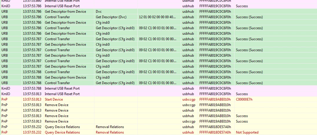

I am now trying to building a USB sound card with microphone.
When I use USBlyzer to monitor the usb communication, it didn't have ''set configuration'' and start fails.
which part is wrong?
