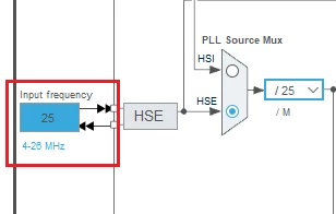

Could you please confirm that your clock source you're using is a 25MHz crystal?
As per your CubeMx configuration? Could you please tell what is the board you are using is it a STM32F4-DISCO board?

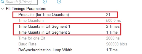

Also, I'm not in favor of these parameters as BS1 and BS2 are too small value with a big prescaler. Please increase BS1 and BS2 and decrease the prescaler with BS1 = ~(70% to 80%) of (BS1+BS2)

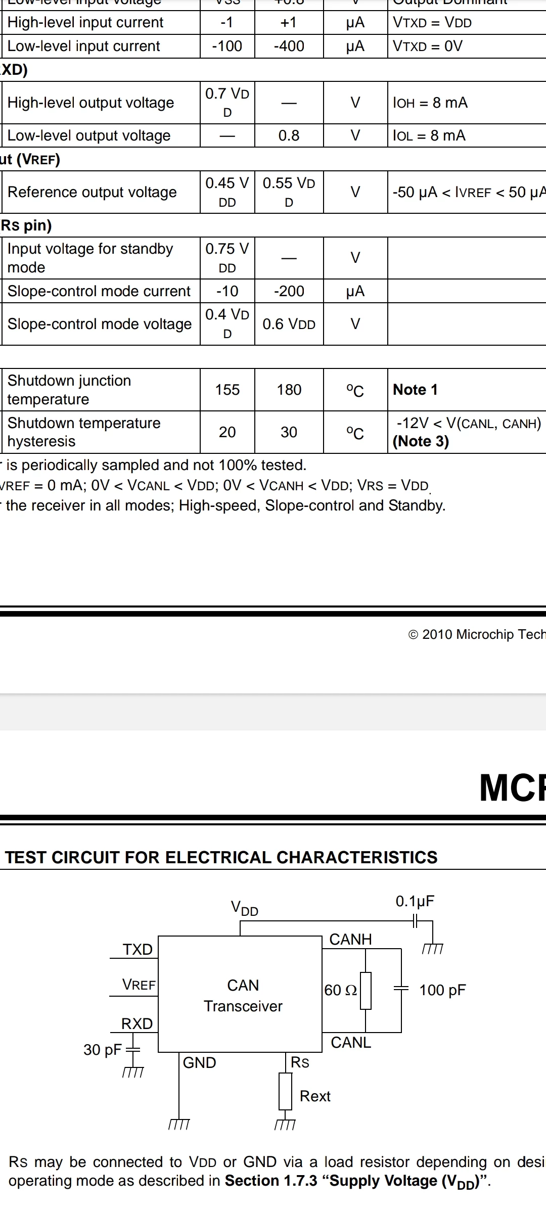

From HW point of view. Is that you who designed that circuit or is it a transceiver module you've purchased?
- The termination resistors are 120ohm and not 60ohm
- Could you also connect Rs pins directly to the GND?
- What is the purpose of 30pF capacitors connected to Rx pins?

I am using MCP2551 can transceiver IC and I made a circuit according to its datasheet. I just made recommended connection in datasheet.
the connection that I get from datasheet is attached
Also, I increased the bs1/bs1+bs2 to %75 and decreased the prescaler so my system worked.the receiving is succesfull.

okey ı will try increase BS1 and BS2 and also decrease the prescaler thank you. By the way, I actually have should altered the input frequency to 8Mhz
My board is also stm32f4 disco
