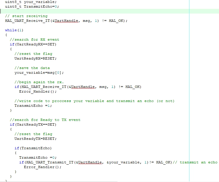

I am having problems with this however. Characters are being lost, I think because of an overrun. Below is an image of transmitted data vs received.
http://i.imgur.com/GTupBhK.png
So what must I change in my code to prevent an overrun?

>> uint8_t msg[] = '';
>> HAL_UART_Transmit_IT(&UartHandle, &msg, sizeof(msg)) >>
HAL_UART_Receive_IT(&UartHandle, &msg, sizeof(msg)
)  sizeof can not be used at runtime to take the length of a string. in your case msg has only one byte length.   msg is an array . you use this array indirectly (&)  try to define a buffer like uint8_t buf[50]; and use it like
HAL_UART_Receive_IT(&UartHandle, buf, length
);  length is the number of bytes want to receive.  Regards

Thanks for the reply. So what do I do when I don't know how many bytes I want to receive?

This question is difficult to answer.
It depends to what you want to do. (some protocol etablished)
An approach is to wait for a single byte,
after to proccess the byte fast enough before the next byte arrives.
and after transmit or not an echo byte(or something other you want.)
But for sure must not blocking the execution by writing while(someting){;}
The TX part of USART must not blocked from RX part and vise versa.
Handle the RX and Tx part asynchronously . something like below
UartReadyTx must be set inside
HAL_UART_TxCpltCallback
UartReadyRx must be set inside
HAL_UART_RxCpltCallback
Stop Blocking!! Start thinking/processing concurrently not sequentially.
