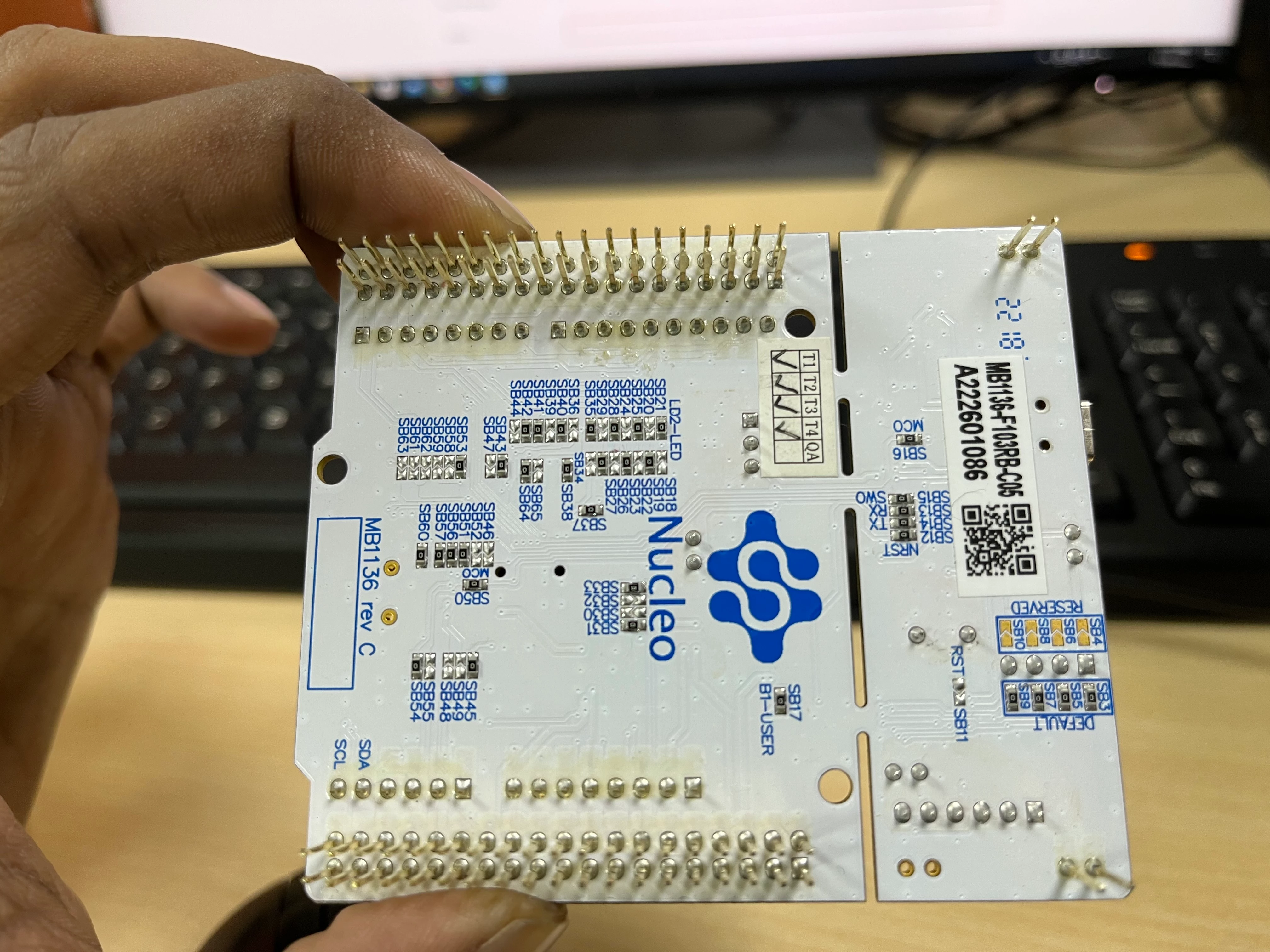

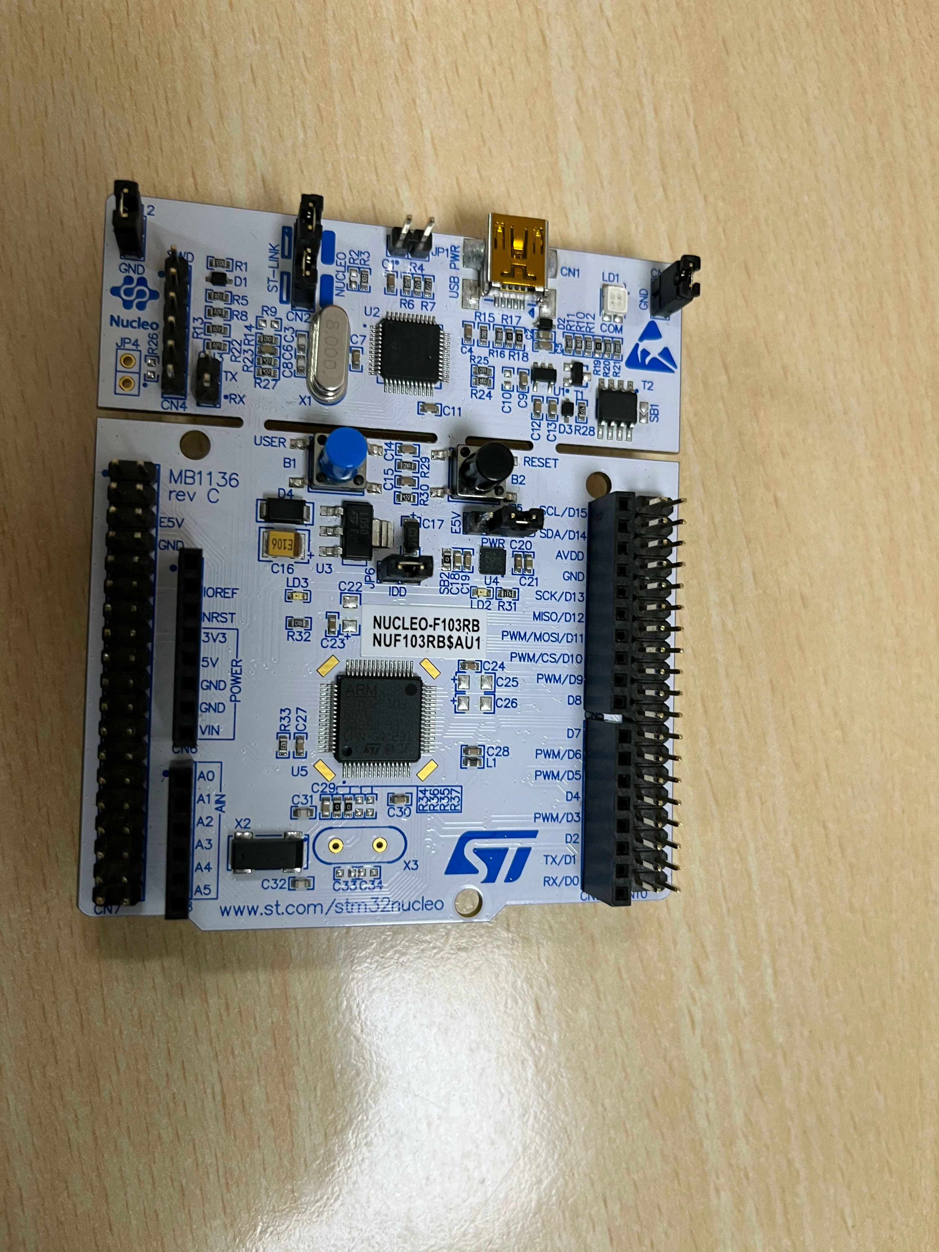

Can anyone tell me why the STM32F103RBT6 getting heated, When ever I connected to the CPU through the USB port the ST-Link will not showing and the code also not Flashing and getting heated.
Thanks,
Kalyan

The MCU is probably destroyed. Most often, this can happen when a higher voltage is applied to a pin, or by short-circuiting pins that are output. Sometimes ESB discharge when handling the board. If the NUCLEO board was brand new and it happened the first time it was plugged in and without any external connections, I would try to claim it.

Hello @Kalyan12
Can you exactly localise the source of heating in the board.
Best regards.
II
Kalyan12Author
September 11, 2023
@Issamos It is heated up exactly on micro controller chip(IC).
Regards,
Kalyan
