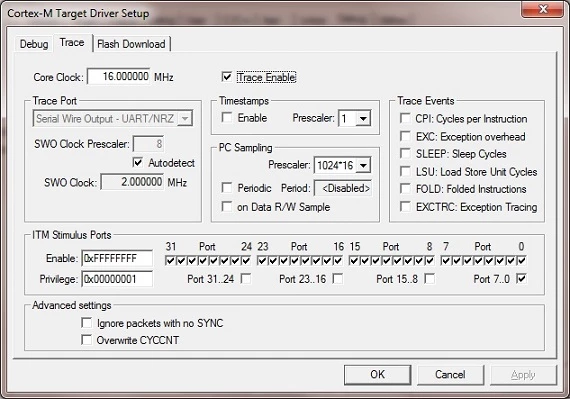

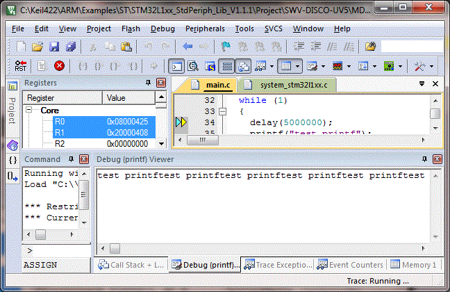

Posted on August 07, 2015 at 02:41
If the bottom of the screen says ''Trace : No synchronization'' you have the frequency wrong.
Here a quick test with uv5 and a Nucleo L152RE, as I don't have a L1-DISCO immediately to hand.
/public/STe2ecommunities/mcu/Lists/cortex_mx_stm32/Attachments/56353/l1keilswv.jpg
________________

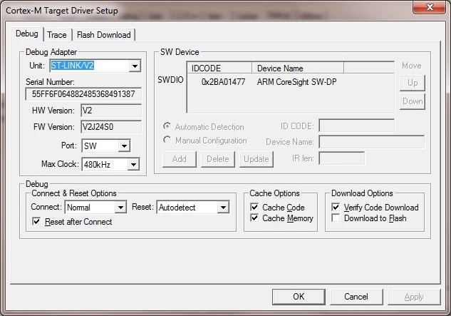

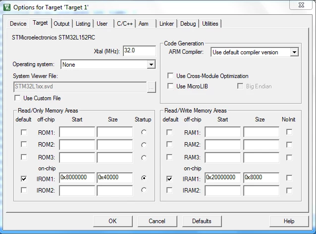

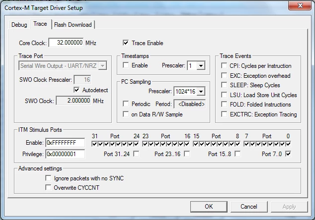

lartigue
lartigueAuthor
August 8, 2015
Posted on August 08, 2015 at 16:31

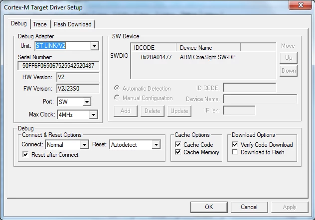

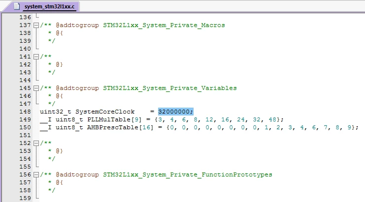

Thank you for your answer but I can't make it work:
- The frequency of my stm32 is set to 32MHz, as you can see below:
I also have the xtal value set to 32MHz:
Debug and trace tabs  are as follows :
At this point, I'm afraid I don't know where else to look.
Tesla DeLorean
Guru
August 8, 2015
Posted on August 09, 2015 at 00:34
The Xtal setting in Keil does nothing useful.
If the clocks don't start properly it won't start the PLL either. SystemCoreClock is only going to be valid if everything starts properly. You could uncheck ''Run to main()'' and walk over this code to be sure it's running as expected.
If the HSE is supplied via the MCO pin of the ST-LINK, then you need to configure the HSE in BYPASS mode.
Suggest you just remove the call to SystemInit in startup_stm32l1xx.s, then the processor will start, and remain, on it's 2.1 MHz clock. Set the trace clock to that.
If you still don't have the SWV working you need to look very closely at how the SWO/PB3 is connected, and that it appears to be functioning.

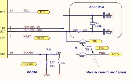

Tesla DeLorean
Guru
August 11, 2015
Posted on August 11, 2015 at 23:01
I'd conjecture that you don't have the X3 crystal fitted and SB17 is not made, and the code in system_stm32l1xx.c is selecting an HSE source that isn't there and doesn't start.
With SB17 made you'd have an 8 MHz source coming from the ST-LINK, and you could select HSE BYPASS mode to use that clock, and drive the PLL at 32 MHz.
