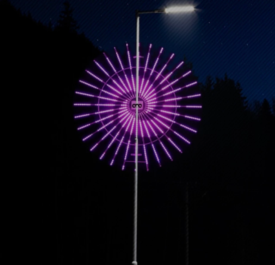

Hello.
I have connected 32 strips of ws2812 connected separately to 32 gpio of stm32f407vgt6, each strip has 30 chips in series, how can I drive all of them? Dma, pwm, uart and spi modes doesn't support this number of strips separately.
Thank you

Thank you, there is many company's built this project with same conditions as I said, I checked they boards, all of them connected 32 strips to stm32f107vct6
