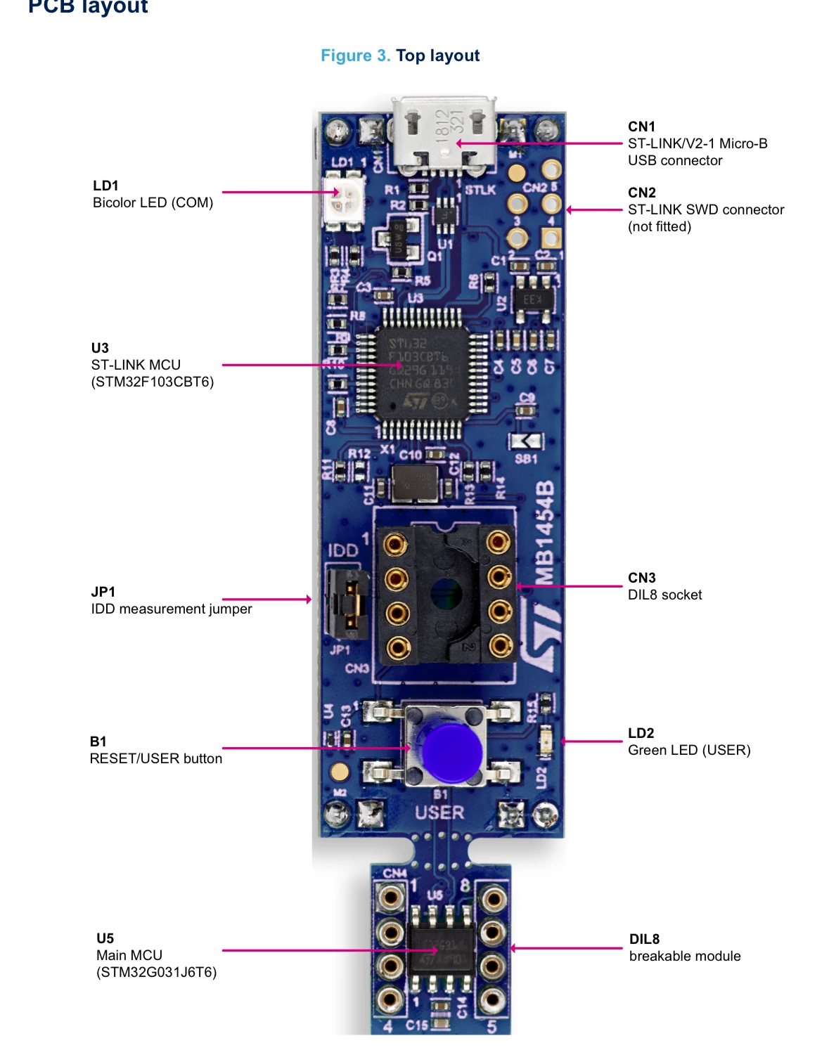

Actually, there is at least one ST board with MCU socket:
https://www.st.com/en/evaluation-tools/stm32g0316-disco.html

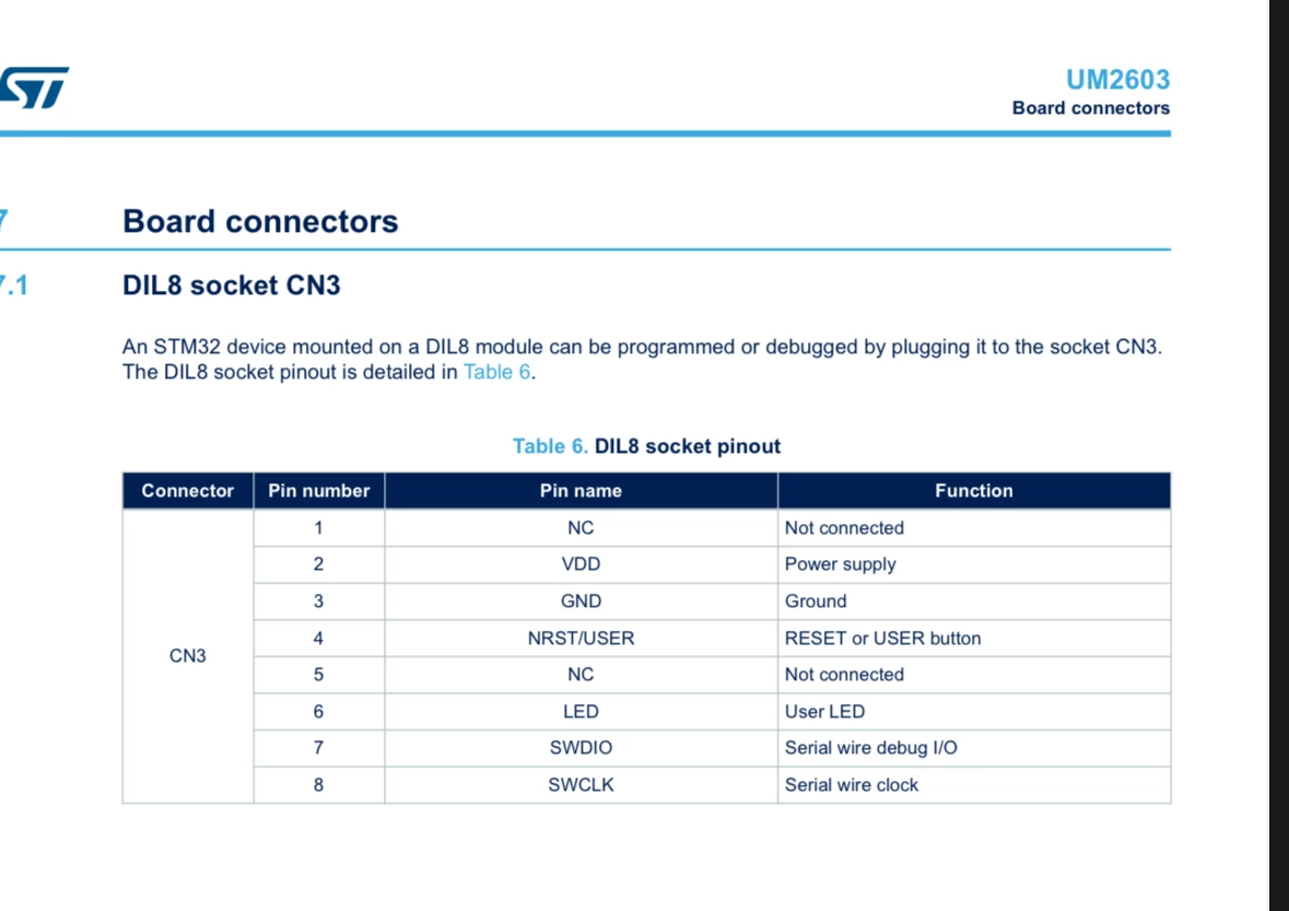

February 23, 2025
Hello @gbm
For this specific case, the main MCU is not mounted on the socket but it is mounted on the  DIL8 Breakable part:
Also, CN3 it is used to program external MCUs :
So, the main MCU is not mounted on a socket.
Best Regards.
