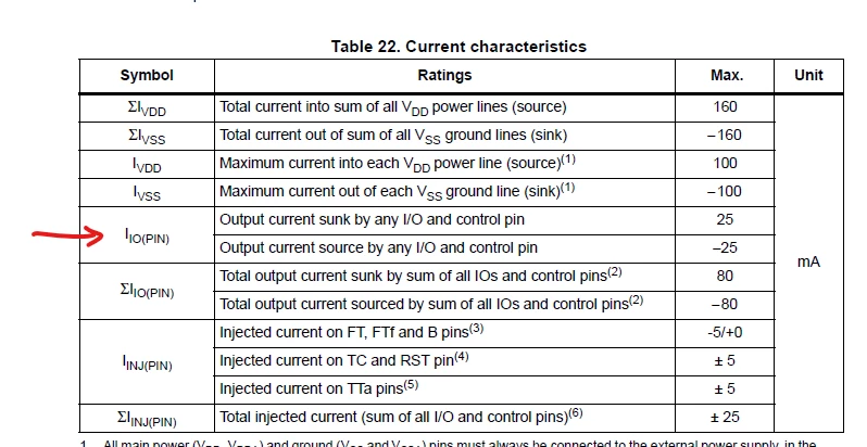

I want to know the DAC output buffer maximum safe output current before damaging the output buffer. I know that it's not possible to get the output swing mentioned in the datasheet under this condition.
The datasheet maximum ratings doesn't state it for the DACs, and from the normal ratings only the current to keep the maximum output voltage around VREF+ can be calculated. So, either I wasn't able to locate the information in the datasheet (which is hopefully the case) or it isn't mentioned there at all.
I'm using a STM32U083 device, datasheet https://www.st.com/resource/en/datasheet/stm32u083kc.pdf
Regards

Page 94-95 table.76 see "Resistive load", min. value R defines DAC's max. output current.

Hello MasterT,
that's the value for normal operation. As I wrote, I want to know the value before damaging the output buffer.

If you don't find this value in the DAC specific section or under "Absolute maximum ratings", you can safely assume it is not individually determined for DAC outs.
Perhaps ST staff can provide you more details.
