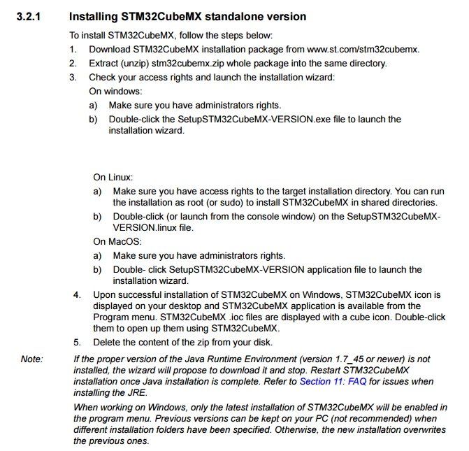

    Posted on April 27, 2017 at 18:59
    Are you following the instructions in this
    http://www.st.com/content/ccc/resource/technical/document/user_manual/10/c5/1a/43/3a/70/43/7d/DM00104712.pdf/files/DM00104712.pdf/jcr:content/translations/en.DM00104712.pdf
     manual to install STM32CubeMX in command-line mode and install the software requirements as Java Development Kit 1.7.0_45 ?
    You should make sure that you have administrator rights.
