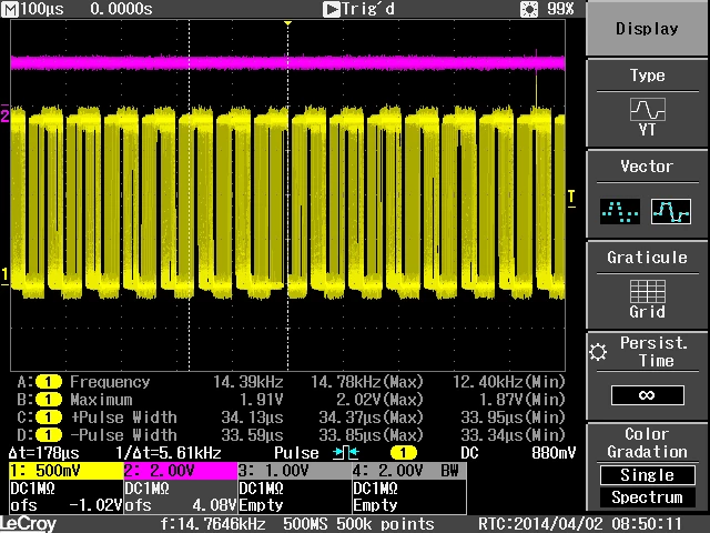

Hello everyone, I'm using STM32F100V8 and I configured TIM4 to generate a square wave (for uart sw). The TIM4 is so configured and should have the highest priority:
  TIM_TimeBaseStructInit(&TIM_TimeBaseStructure);
  TIM_TimeBaseStructure.TIM_Period = 1;
  TIM_TimeBaseStructure.TIM_Prescaler = 405;
  TIM_TimeBaseStructure.TIM_ClockDivision = TIM_CKD_DIV1;
  TIM_TimeBaseStructure.TIM_CounterMode = TIM_CounterMode_Up;
  TIM_TimeBaseInit(TIM4, &TIM_TimeBaseStructure);
  TIM_ITConfig(TIM4, TIM_IT_Update , ENABLE);
  NVIC_PriorityGroupConfig(NVIC_PriorityGroup_1);
  NVIC_InitStructure.NVIC_IRQChannel = TIM4_IRQChannel;
  NVIC_InitStructure.NVIC_IRQChannelPreemptionPriority = 0;
  NVIC_InitStructure.NVIC_IRQChannelSubPriority = 0;
  NVIC_InitStructure.NVIC_IRQChannelCmd = ENABLE;
  NVIC_Init(&NVIC_InitStructure);
Inside the ISR of TIM4 i toggle a MCU line and my scope show me that the clock has a very high jitter; Could someone give me some suggestion to make te clock more stable ?
 Here attached an image from my scope acquired on a long time with infinite persistence time
#stm32-clock-jitter-tim4

Don't toggle the output pin ''manually'' in the ISR. Rather, use one of the output compare channels and set it to change state in the ''future'' as needed.
A completely different approach may be to use the timer as trigger for DMA transferring from a prepared array in RAM to GPIO.

... to avoid the jitter caused by the zillions of factors causing variable latency of the ISR....
Mind, this is NOT a microcontroller. It's a SoC with relatively loosely (as far as timing goes) coupled modules.

You can, but it's the stupid plan, the TIM peripheral is capable of toggling pins on a hard time line, or generating pulses, etc directly. If you do it in software you get to see all the latency and variability in the servicing.
