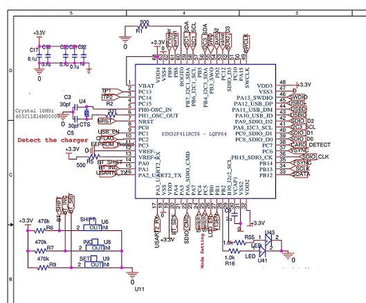

    Please help checking the schematic if there is anything wrong.
    As the power supply, I use RFE3033, which is capable to output 25mA current, is it enough?
    In the microcontroller, I use the module of I2C1,I2C3,USB, timer9,10,11, SWD debug, and the system is running at 96MHz using 16MHz internal clock(I could use external clock too).
    Do you think 25mA current is enough?
    My question is if power supply is the reason, why adding couple lines would significantly change the system?
    Thanks

    Assuming the supply is browning-out, suggest you use a 2 ch scope, trigger on falling edge of NRST on first channel, with second channel attached to supply.
    rwmao
    rwmaoAuthor
    Senior
    December 12, 2015
    Posted on December 12, 2015 at 03:05
    Thanks Clivel for your suggestion to check voltage.
    Finally I figured it out.
    It is caused by the power supply, which can only supply 25mA.
    I put two REF3033 in parallel to provide 50mA supply. Now it works.
