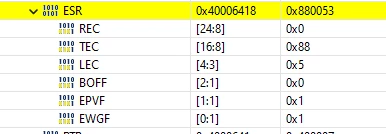

hello I today trying can communication loopback mode working but normal mode bit LEC register showing timing error.

Indeed.. CAN is not UART nor SPI to test it in standalone. In Normal mode you should have at least two nodes on the bus for acknowledgement mechanism and listening of the bus. Otherwise use loopback mode for standalone config.

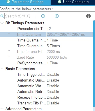

Also, the values of BS1 and BS2 are not good to me. Please increase BS1 and BS2 as much as possible and decrease the prescaler as much as possible to match your 500kb/s knowing that BS1 must be between 70% and 80% of the bit time.

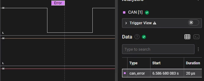

I checked the RS pin, there was no problem, then I solved the bit timing problem by editing the time segment quanta and prescaler values, but the only thing I'm curious about is that when my device is not connected to any node, something like this picture appears as a frame from my CAN TX output.

Hi @Sergen @mƎALLEm @Tesla DeLorean after using two nodes also i am getting the same waveform.
