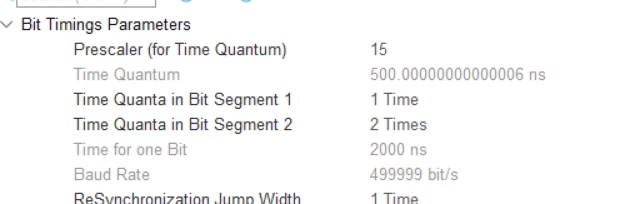

I am trying to send messages from Can1 to Can2 in an stm32f205vet6. HAL_CAN_AddTxMessage is returning HAL_OK but I am not able to receive any messages in CAN2. And I cant see any messages transmitted in a scope.
clock speed = 120Mhz
Can speed = 500 kbps
My code below

 hcan1.Instance = CAN1;
 hcan1.Init.Prescaler = 15;
 hcan1.Init.Mode = CAN_MODE_NORMAL;
 hcan1.Init.SyncJumpWidth = CAN_SJW_1TQ;
 hcan1.Init.TimeSeg1 = CAN_BS1_1TQ;
 hcan1.Init.TimeSeg2 = CAN_BS2_2TQ;

 hcan2.Init.Prescaler = 15;
 hcan2.Init.Mode = CAN_MODE_NORMAL;
 hcan2.Init.SyncJumpWidth = CAN_SJW_1TQ;
 hcan2.Init.TimeSeg1 = CAN_BS1_1TQ;
 hcan2.Init.TimeSeg2 = CAN_BS2_2TQ;

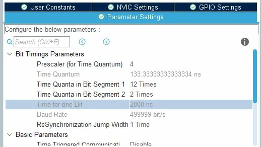

Best answer by SKacp.1
For Clock 120 MHZ on the APB1 peripheral clock You have max 30 MHz for CAN
So I propose change settings as below:

First questions: How You have connected CAN1 and CAN2? You use external transceivers?
Best Regards
Slawek
JThom.15
JThom.15Author
April 21, 2023
I'm using TCAN10444 Can transceiver on both sides and has got termination resistor on both sides

Both CAN uses the same bit time parameter, the CAN1 and CAN2 init code are auto generated to get 500kbps
SKacp.1
SKacp.1Best answer
April 21, 2023
Karl Yamashita
Lead III
April 21, 2023
Change CAN2 to canfilterconfig.SlaveStartFilterBank = 14;
