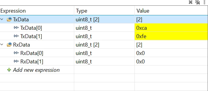

I have made the changes you suggested. But still also I am  getting the same.
mƎALLEm
September 10, 2024
Could you please share your project including the ioc file? if you don't want to share it in public send it to me in PV. Compress it as .7z file.
